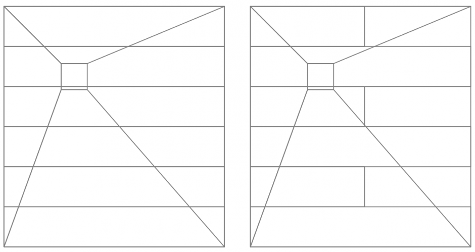

I am about to lay a walk in shower with 120cm X 20 cm tiles.
In general the room will be a "brick" type layout.
The walk in shower is closed on 3 sides and borderless on the front.
The drain is a hole type drain which is off center, which means I will have to generally cut the 'v shape' to follow the contour of the shower floor.
The shower is 110X120 cm which means a single tile will fit the entire length - but will have to be cut to follow the contours.
My question is: should I follow the brick pattern like the rest of the room - introducing a new grout line, or simply tile this part with the minimum grouting necessary?
Here are the two examples:
thanks in advance for any insight!
