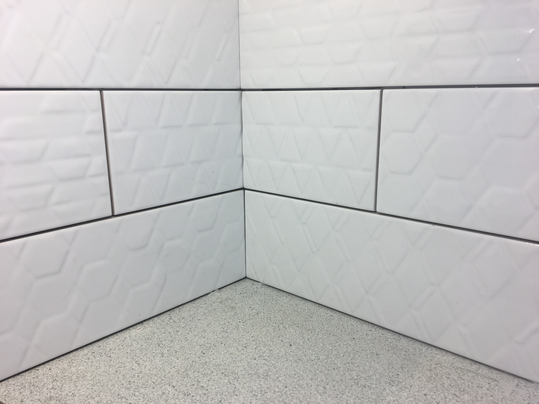

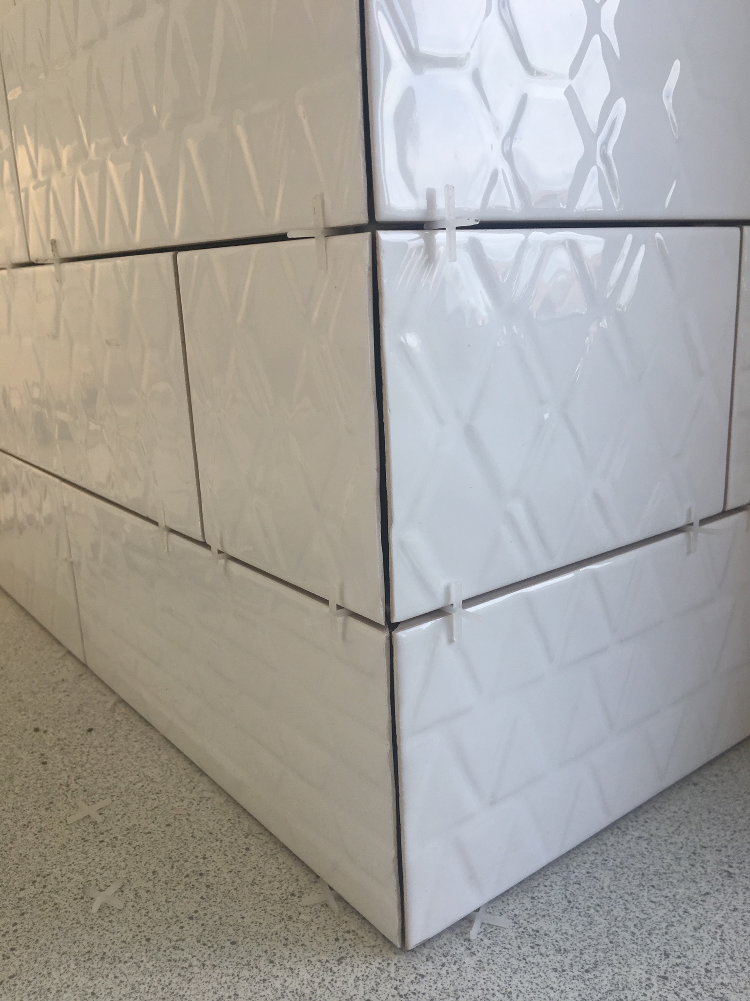

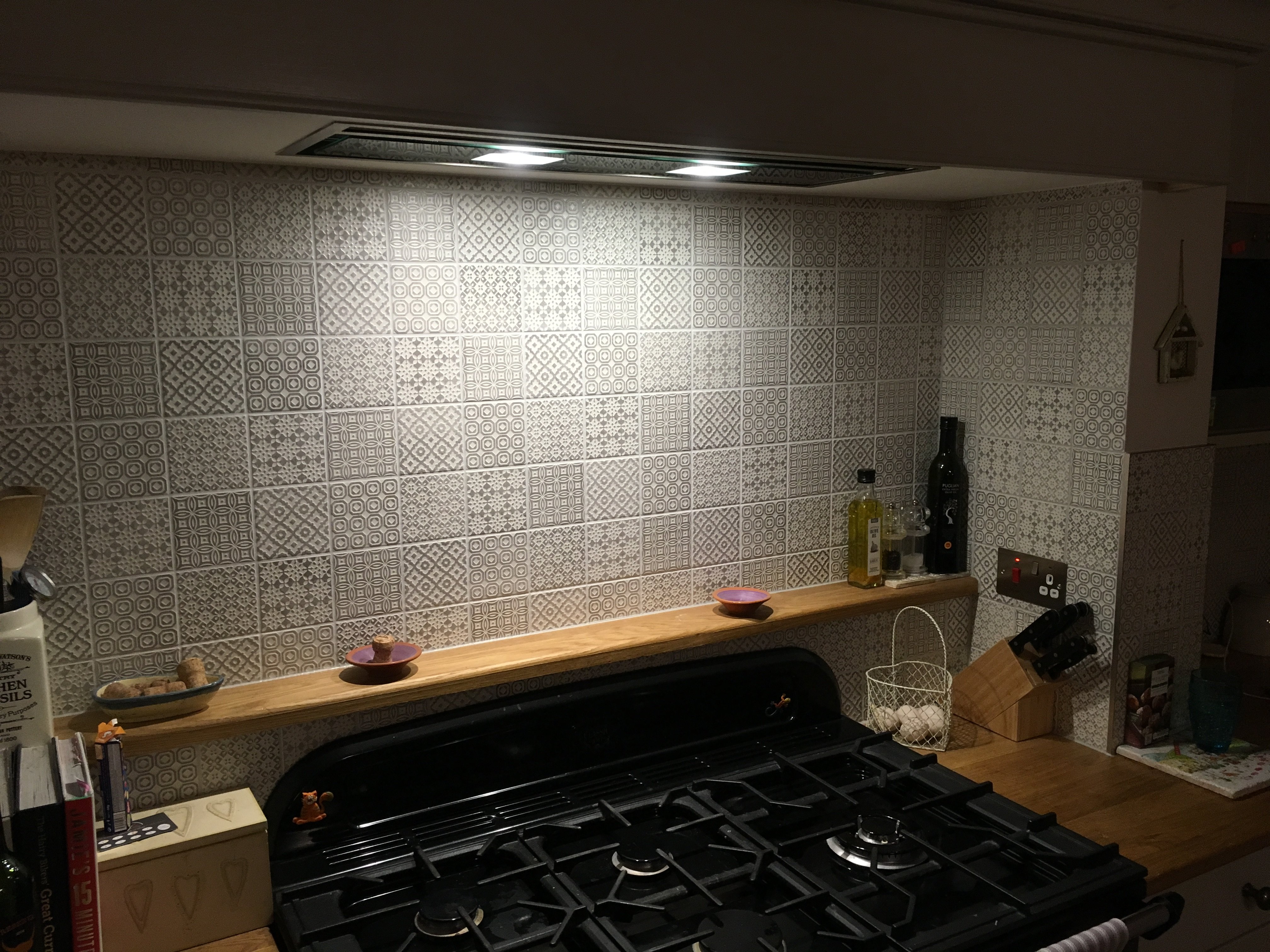

I didn’t wrap the tile round on my kitchen, as I couldn’t get half a tile each side it made the corner tiles look longer and I preferred it this way visually. View attachment 104778
Thank you very much for sharing, the tile and job looks superb. I've taken note here of what you have done in corner and most likely will follow the same idea.

I think you get away with it as the right hand wall has a full tile in the corner, hence you have nothing to wrap around.
Unless of course you changed the layout on the right wall to wrap the pattern round but that’s beyond what I can see. I think it looks fine regardless.

Personally I prefer it as @Boggs has tiled it, as it's ment to be a random pattern..
But as in most things tiling it's a personal choice....
If a client told me they want a random pattern then that's what they get...

A few more for you.A3C64D4E-9FE4-47A3-99AB-570526D5600E.jpeg0CED0F66-5AEC-4769-B7A9-4D8F5E341945.jpeg 39E37679-DA26-4A6D-AF6F-7EF50CA1130D.jpeg9B7FC6E3-377C-4637-8830-F123C60B6BF5.jpeg 204125F8-9A9D-4581-A44F-75A8D664BE44.jpeg
The middle tile in the picture above wraps round, only just realised!
For me they look better random but that’s my personal choice and looked better with how my corners were working out.
