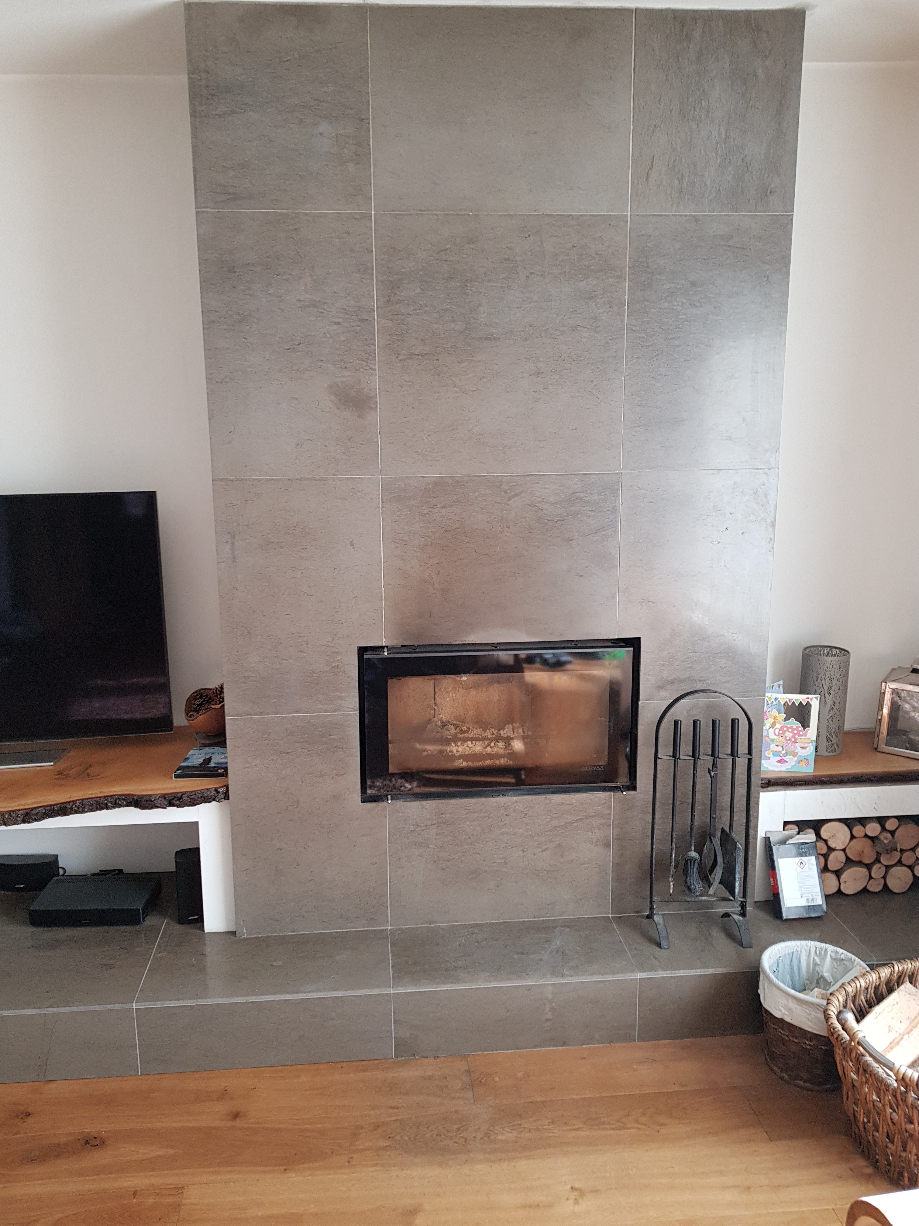

I recently posted a question concerning some 600 x 600 x 10 limestone tiles I have fixed to my chimney breast. These are coming away for the 3rd time. They were fixed using a Vitcas heat resistant https://www.tilersforums.com/forums/tile-adhesive/ and grout. The answers I got from the forum were not very helpful, so I contacted Vitcus with the same questions. The answer I got back is below,
"We believe the tiles are coming away because of they are a considerable size and weight for our tile https://www.tilersforums.com/forums/tile-adhesive/ to hold alone and we advise that they are mechanically fixed in place.
When you reattach your tile(s) we recommend that you use our VITCAS Heat Resistant Tile https://www.tilersforums.com/forums/tile-adhesive/ with a full 3mm coverage across the whole back of each tile. This is best achieved using a 6mm tile comb which distributes the https://www.tilersforums.com/forums/tile-adhesive/ evenly and consistently. Our Heat Resistant Tile https://www.tilersforums.com/forums/tile-adhesive/ should also be using in conjunction with out VITCAS PVA Sealer. The PVA would need to coat the wall and the back of the tile first, applying the product neat. Once the PVA is sticky and tacky you can apply the Heat Resistant Tile https://www.tilersforums.com/forums/tile-adhesive/ to the back of the tile and apply to the wall . You do not need to wait for the PVA to dry fully".
based on this advice from Vitcas I have 2 questions
1) is there such a thing as mechanical fixing to assist holding the tile up? ( please don't suggest drilling the face of the tiles and attaching with screws).
2) based on my reading of this forum there is a resistance from a lot of the members to using PVA, why?
