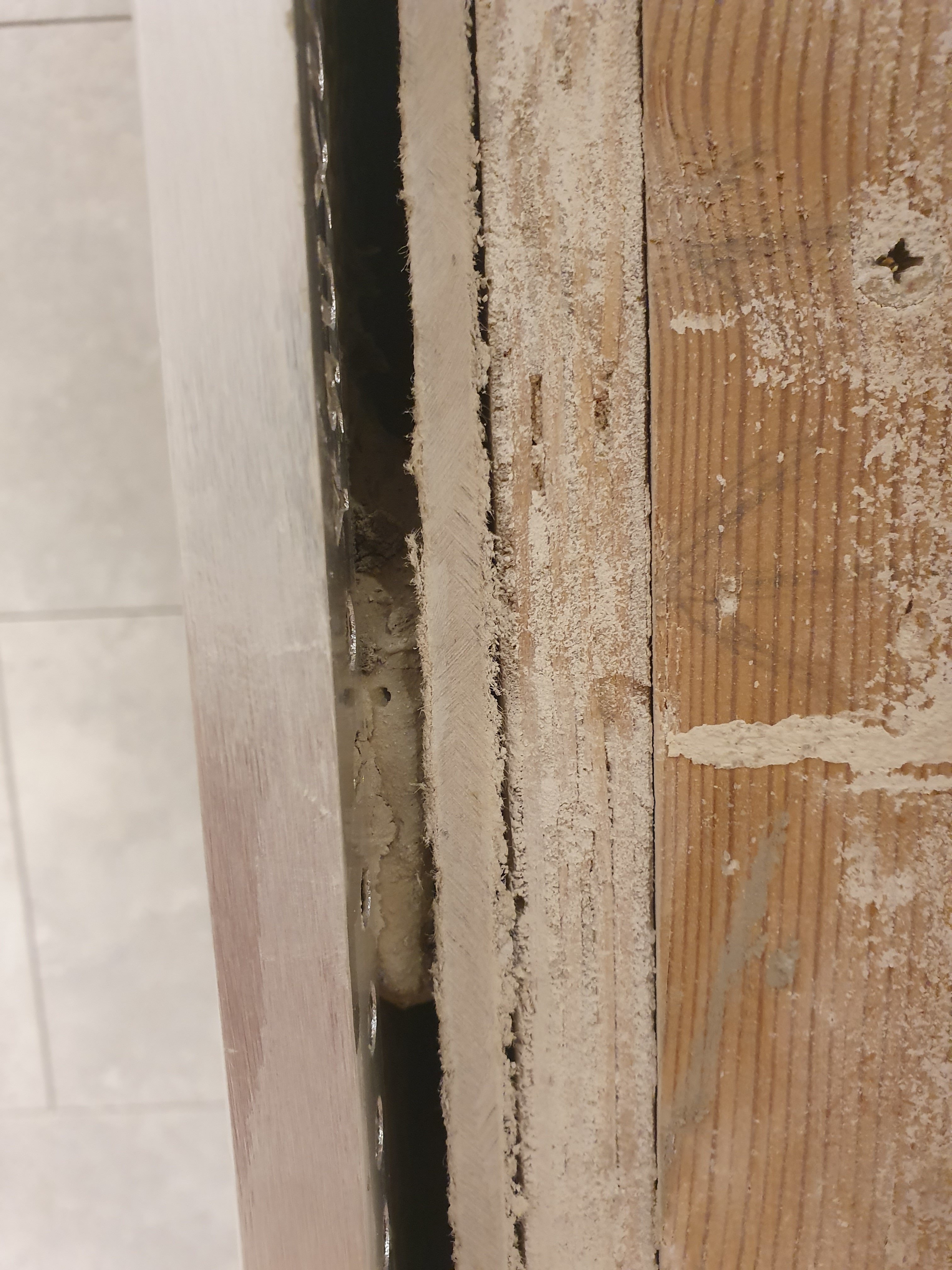

On another note, I sent him an email detailing all the work needed to rectify so he sent back the Electrician (we do have a Part P cert for his work, including the fan), I was at work, my wife has a few days holiday booked so dealt with him. He went up the ladder and put a 'vent' in, she said he didn't go in the loft or even enter the house, so got my ladders off the van and went in the loft, this is what I've found.
View attachment 110615 View attachment 110616

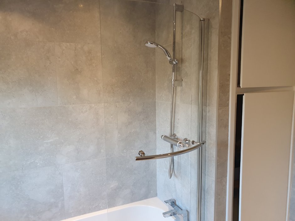

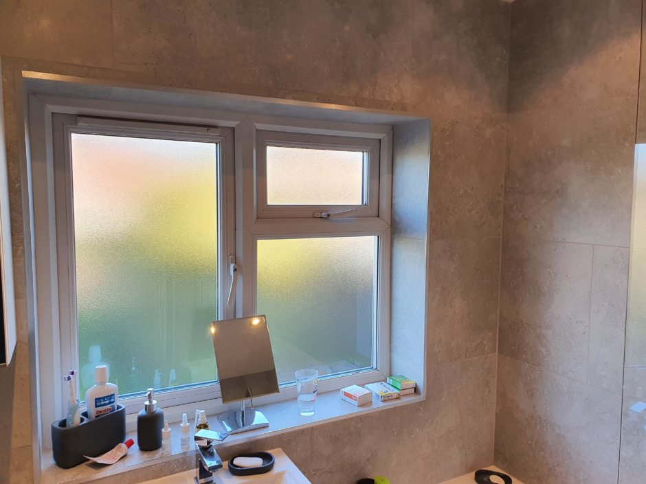

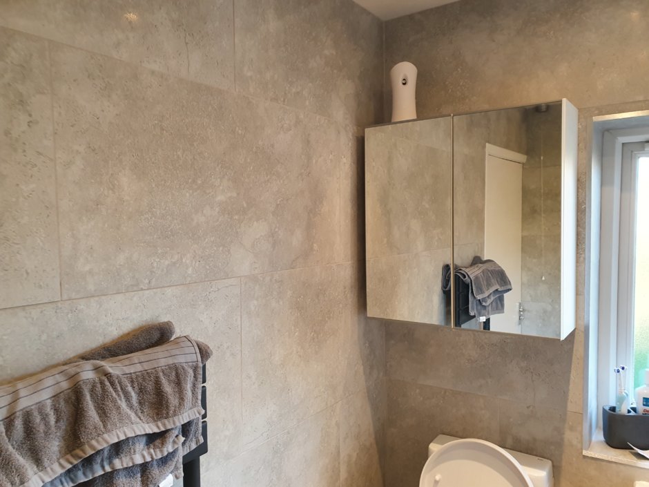

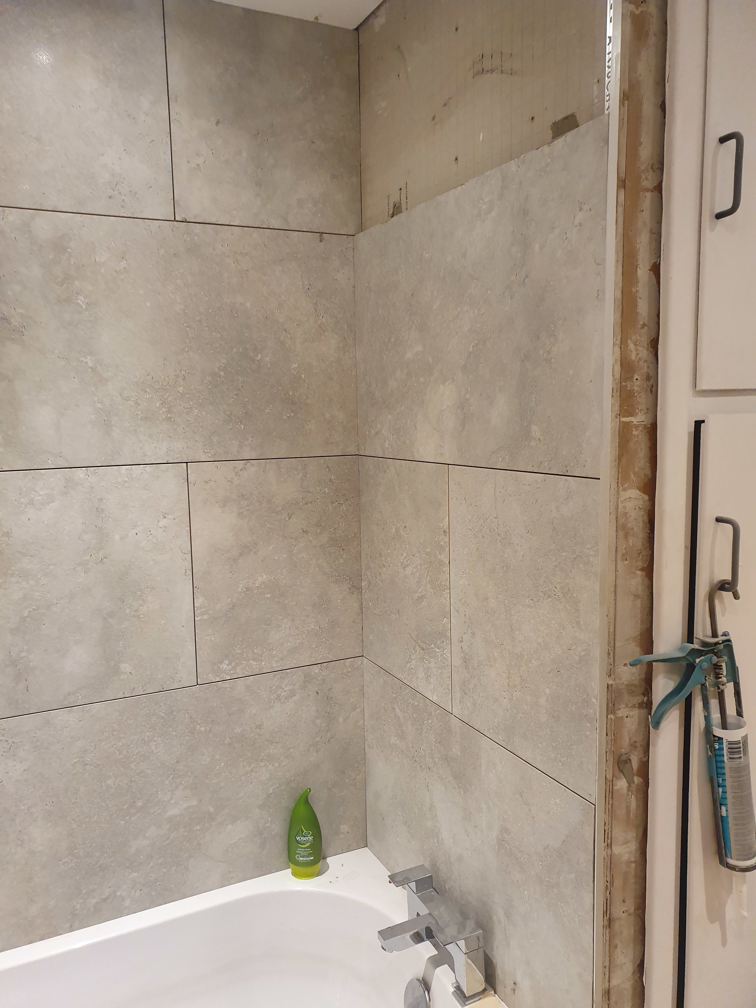

Well, this is the result of the finished tiles, I didn't feel like I had a choice but to let him finish as he had done 80% of the tiling by the time I figured out what he was doing was wrong and he had ripped out the sink as soon as he started, so we had been washing out of a bucket for 5 days and the temporary toilet he put in wasn't even fixed to the floor.

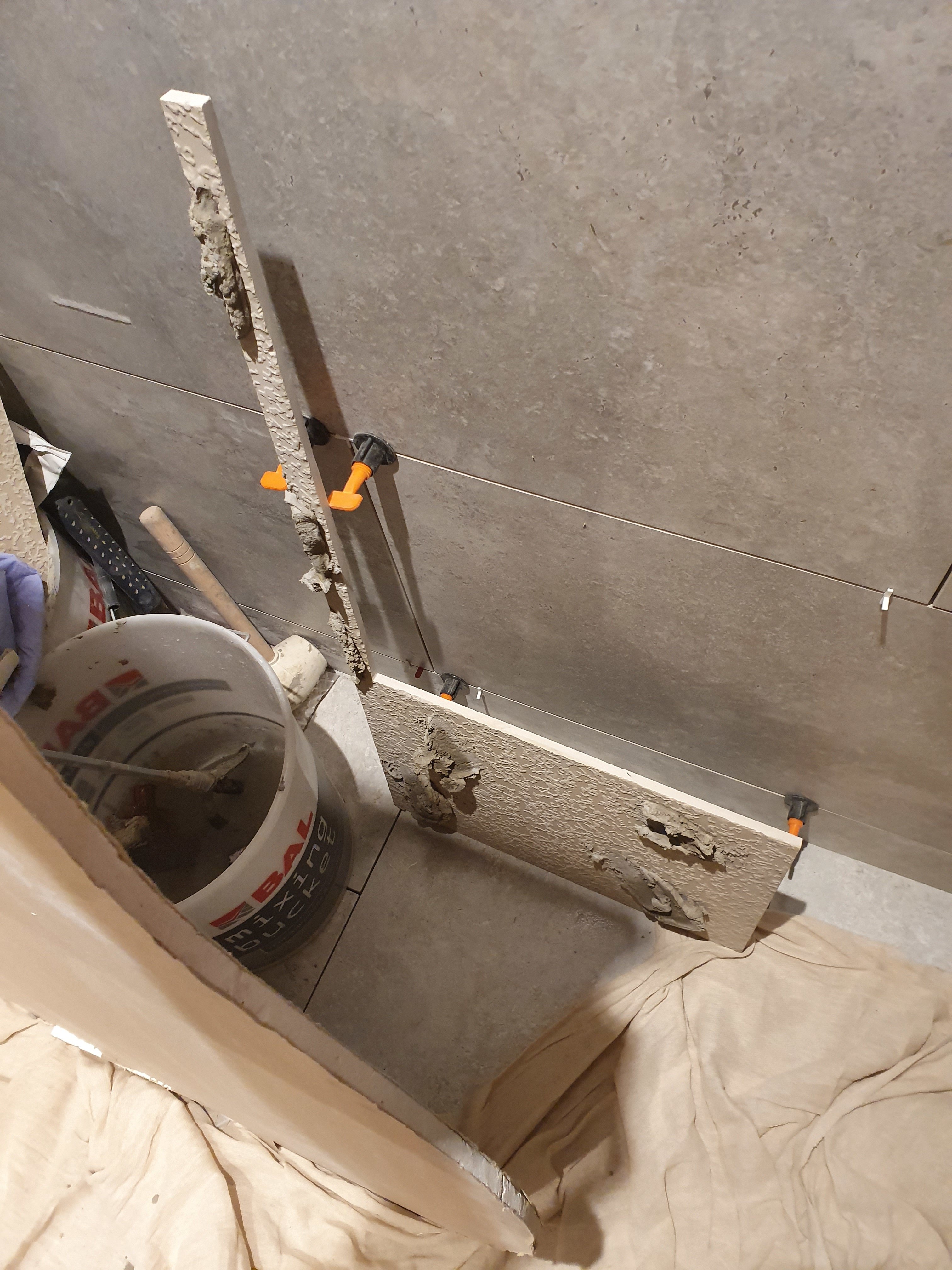

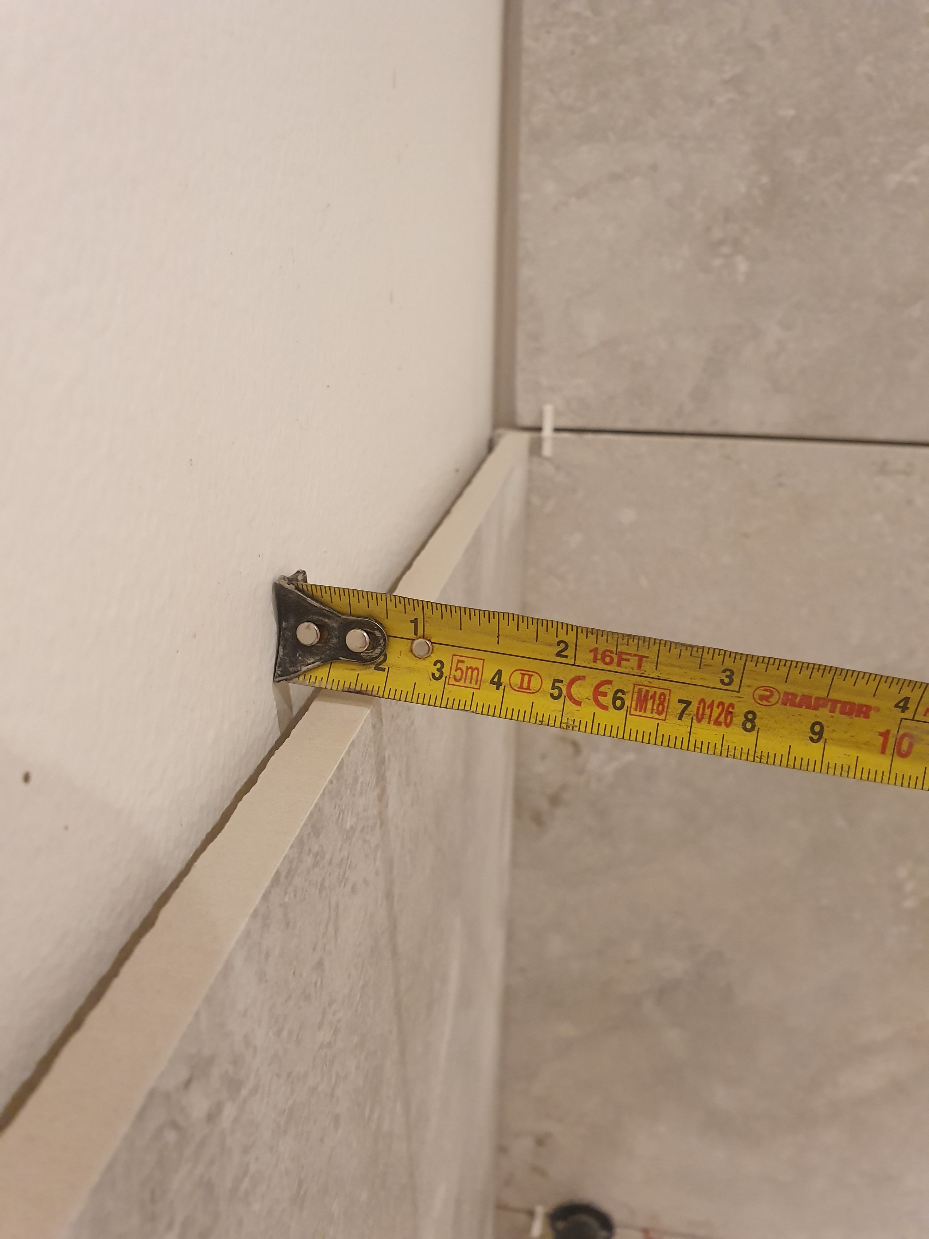

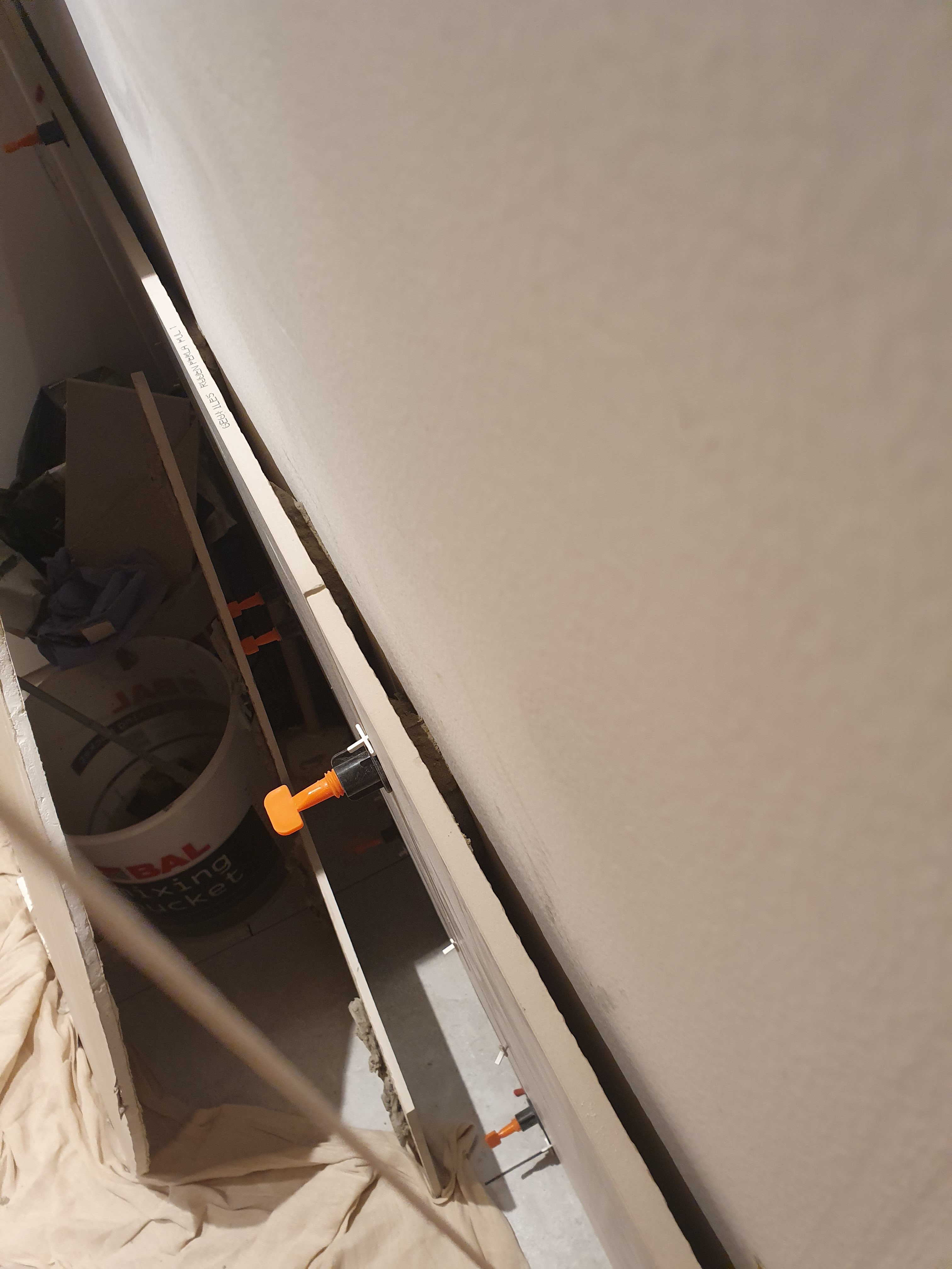

I told him I was concerned they were going to fall off so he removed 1 tile to show me how well it was fixed to the wall but chipped the one underneath, he said he would remove them all, then I could have the wall plastered and he would come back and put them back on.
The tiles cost me £800 and I didn't want him smashing them all off the wall, I don't know what the chances are of him getting them off the wall and removing the cement at the back without damaging them.
The reason I wanted the bathroom renewing is we are planning on selling soon but I don't want to sell the house and a tile to fall off and injure someone later on.

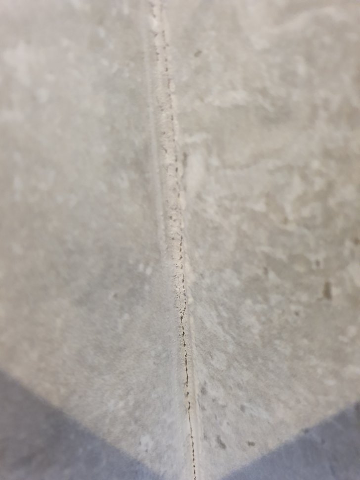

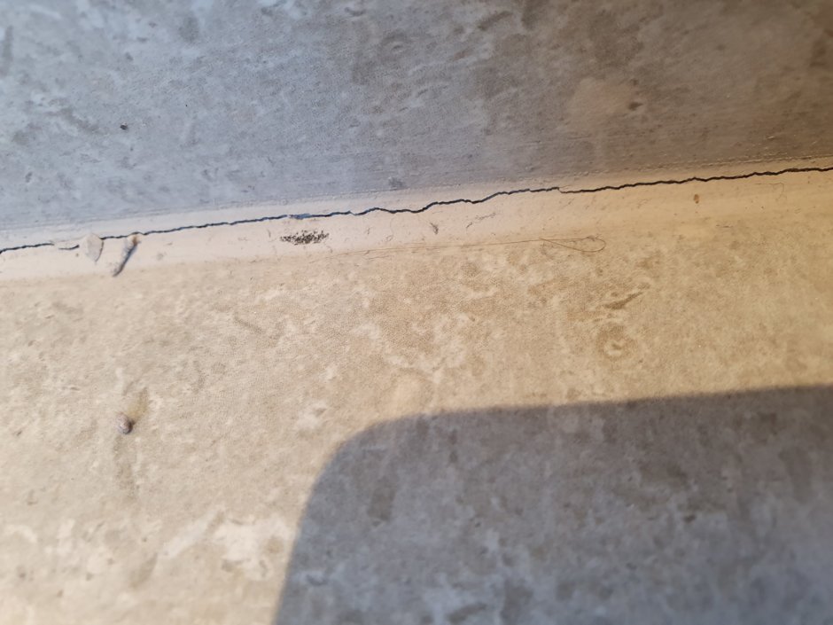

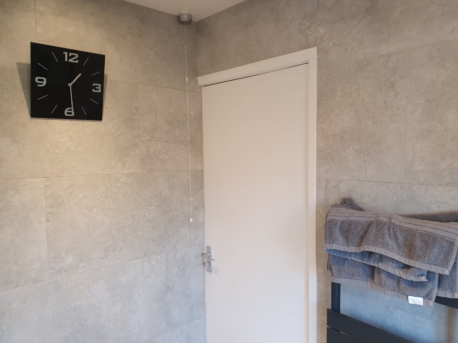

The edges of the tiles have cracked by the shower and on the floor as predicted due to no expansion gap and now I've lived with it for a while think his setting out is poor on the wall where the clock is.
To ensure I get it done correctly now, what should be the sequence of events, tiles removed, walls plastered and then tiles fixed back on a full bed of cement?

I phoned the tile company I bought the tiles from and they told me the weight of the tiles are 20kg per square metre (450mm x 900mm), considering the walls are plaster on brick, which I believe support 20kg per square meter, then with the weight of the adhesive this will not support the tiles that are currently one the wall.
What would you advise I do please, pick a different tile, remove the paint and have them fixed with a full bed of cement or just have them all removed and paint the walls, just keeping the tiles on the 2 walls around the bath for the shower.
How can I find a tiler that knows what they are doing? The owners of the tile shop don't have a clue, he just said that a plastered wall can support 32 kg and it's ok to put the heavy tiles directly to the painted plaster as long as I do a 'tape test'. :rolleyes:
