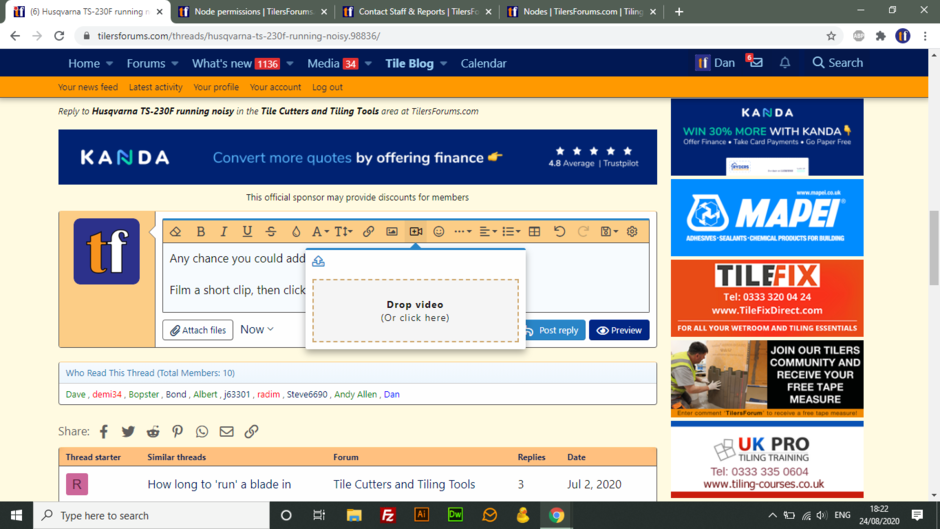

Any chance you could add a video to the thread of it running?
Film a short clip, then click the video button to add the video to a reply.
