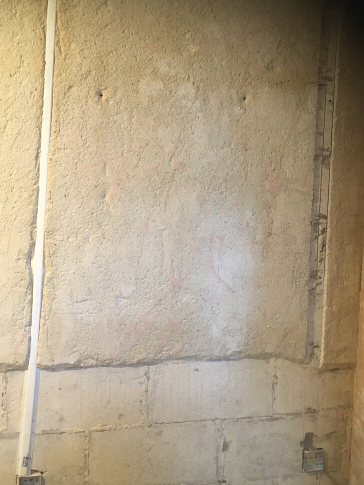

I’ve attached a picture of what it looks like, although this isn’t one of the walls I intend to tile. I haven’t scraped the defective gypsum plaster off of those just yet, I’ll be doing that when it comes time to do the kitchen and bathroom but I anticipate them to be the same as this.
