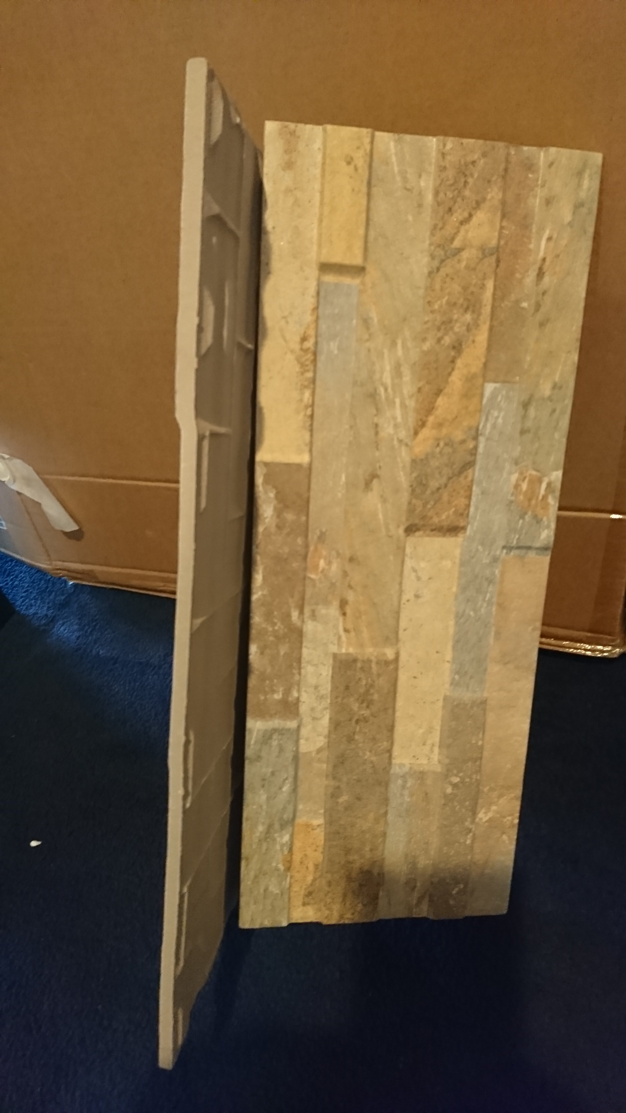

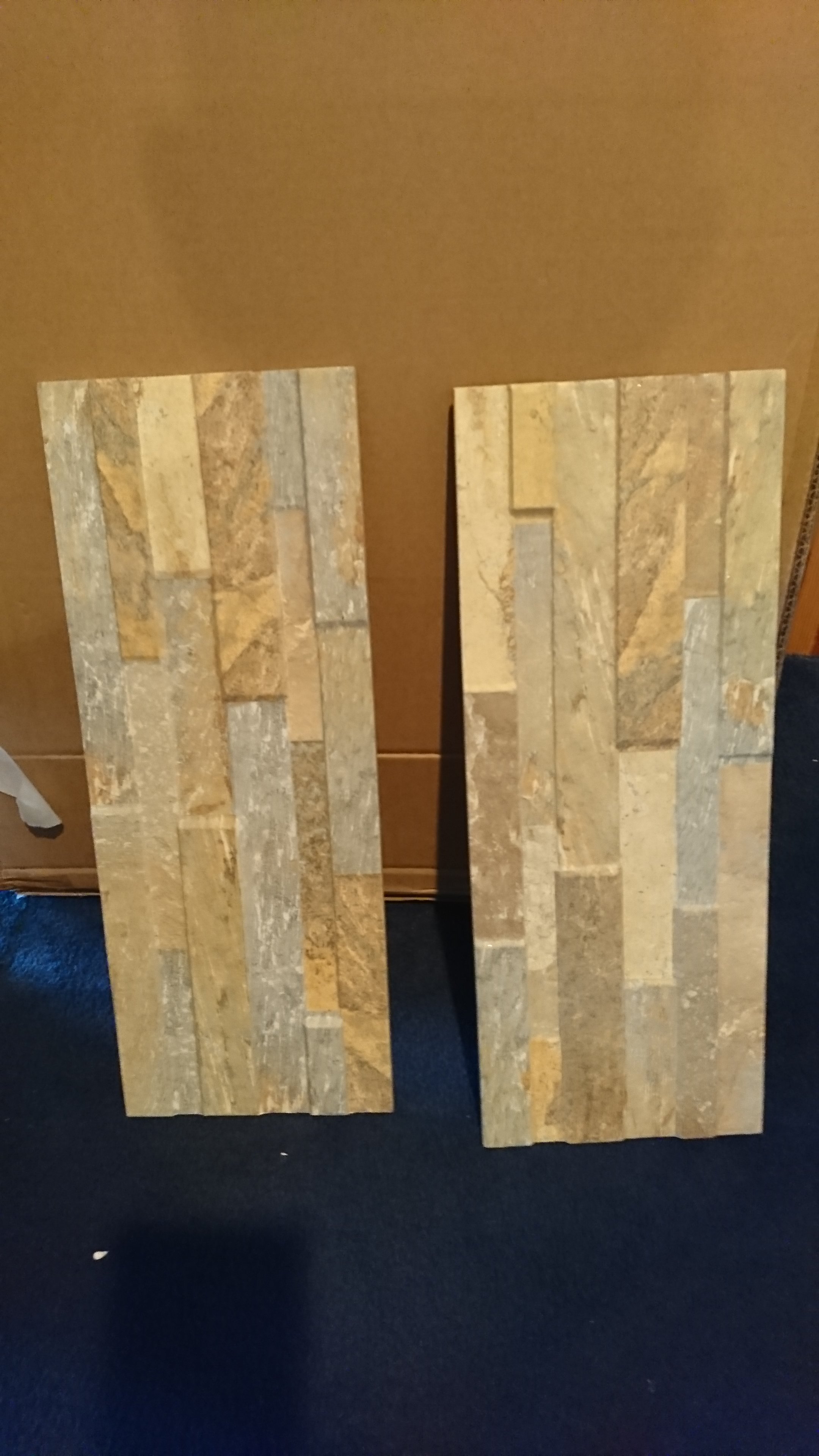

My customer has bought these for her kitchen, I've sorted out how I'm going to do the switches & sockets, but it is any bare top edges that are going to be on show. Has anyone any experience of these or can anyone recommend a way to finish them off to make them look good?
Also how to finish around the window reveal, would mitring them work?
I've shown the edge as well as the face.

Those are not true split face, they are a one piece tile that has been stamped to look like split face.
Mitrering those would be best for the corners but you may need a 5mm joint for it to look nice. As for the top.... just grout and paint is my suggestion.

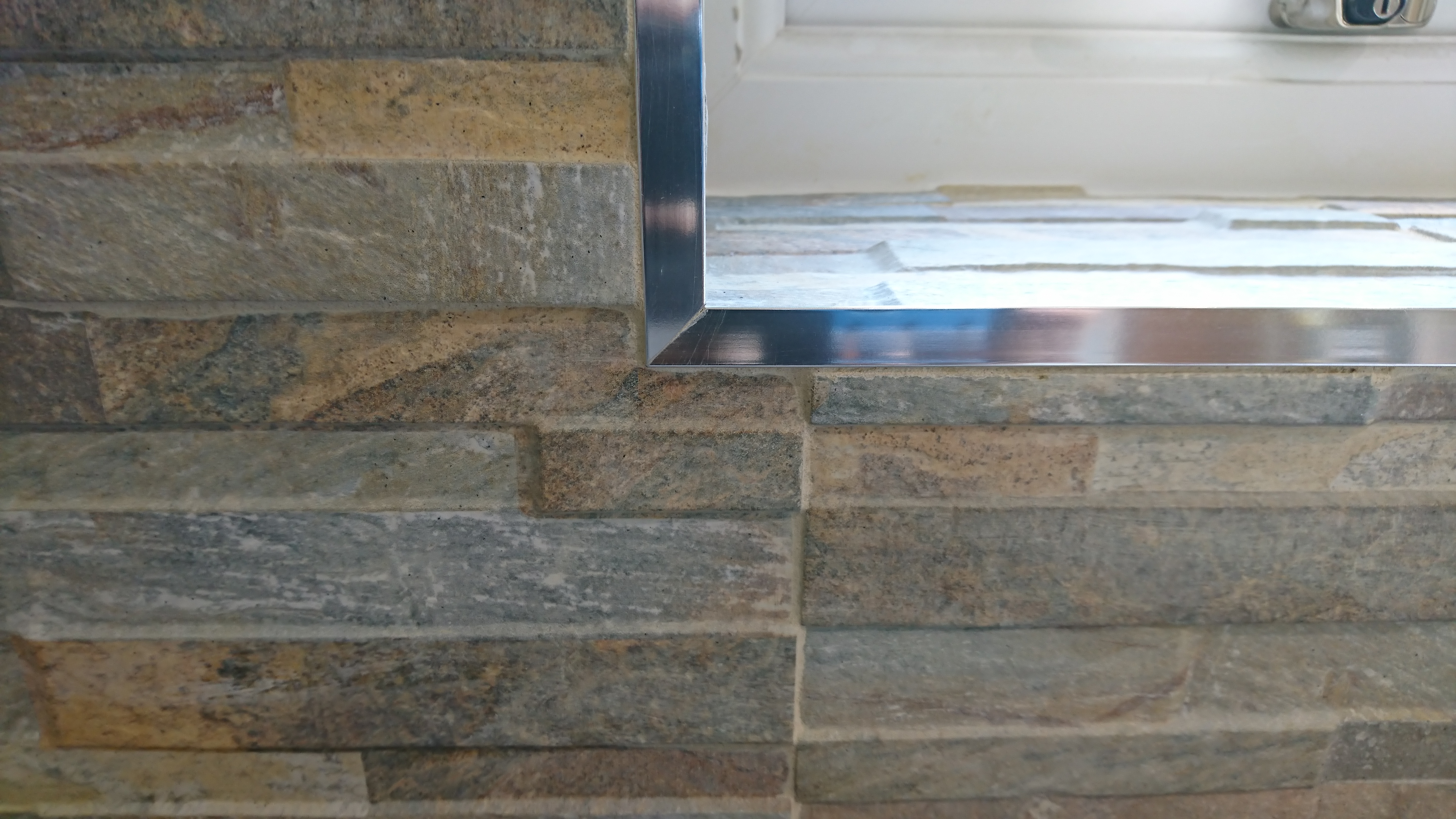

In the end I decided to try some 12mm square edge chrome edging.
Comments welcome, Thanks

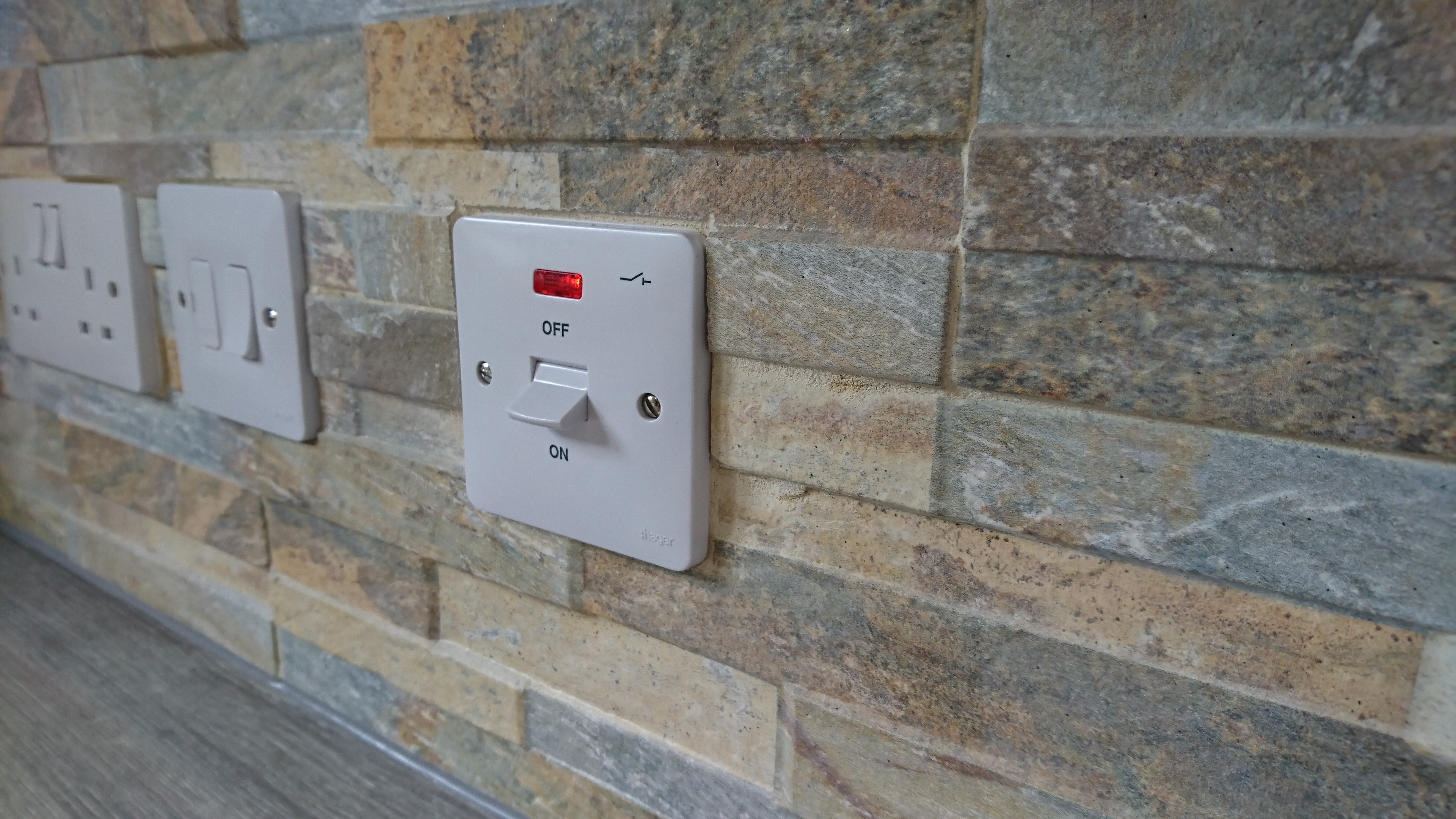

This is how I did the switches & sockets.

I've set this type of tile a few times and brushed satin beats everything else for me, gives it a clean edge but not as bright as chrome. Nice job though MalcyB, sockets look good too.
MalcyB
Thanks tilergal. She went with chrome because it went with other things.
I put a 10mm single or double spacer behind each, they would have been better if they were 12mm.
