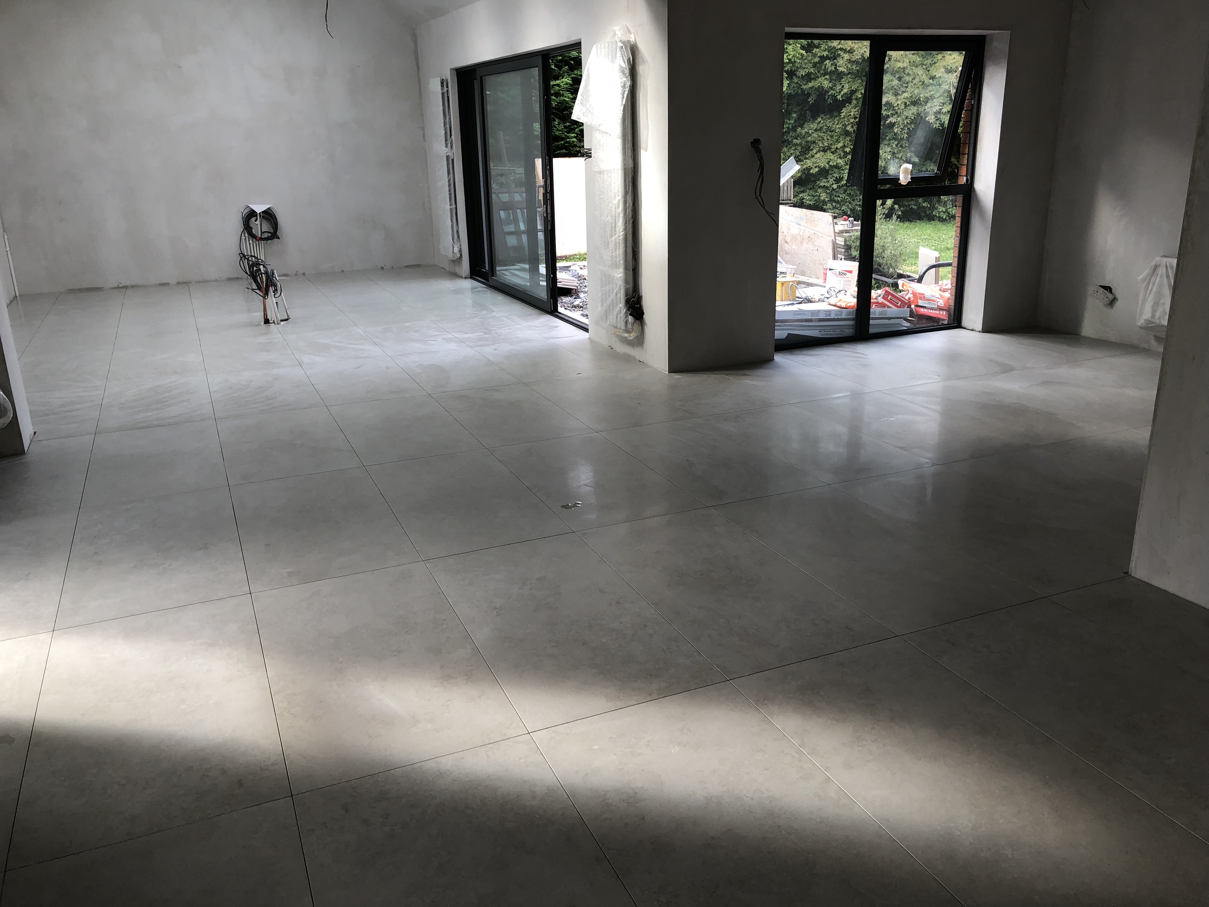

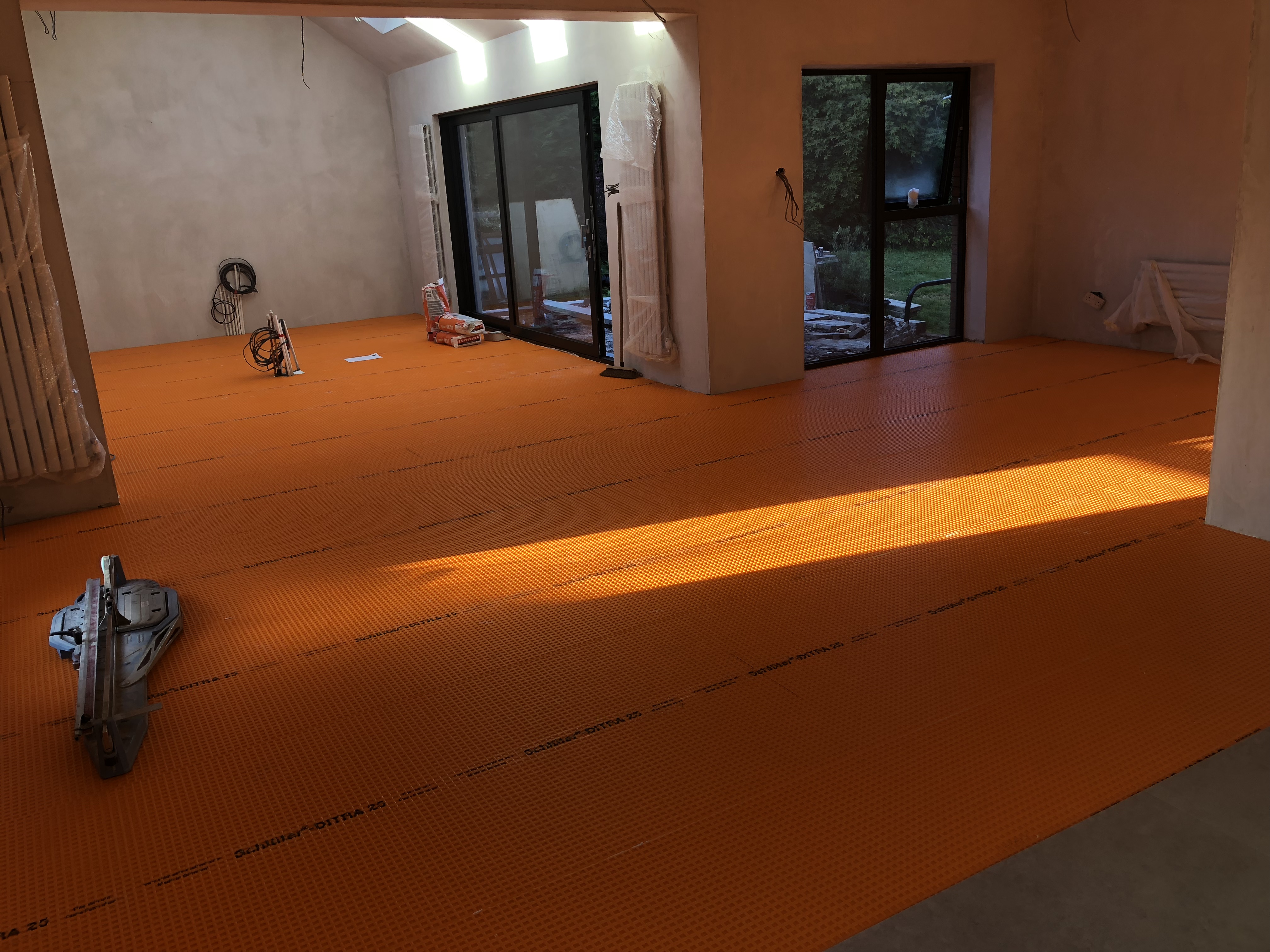

7D5AC6E2-4A4C-4DE6-901E-7CDBEFA4CCF5.jpeg 28B067F3-56CD-455A-8F5B-1589312D86DC.jpeg 8713E4C5-913C-4729-BC54-1BD12A3815DE.jpeg D25BF7B0-E3E5-436C-A6EB-703797AFE9FA.jpeg This week for the first time I used @ISOMAT UK AK 20 to install @Schlüter-Systems Ltd Ditra and a 1200x600 porc tile. The area was 65 mts. I used the standard Schluter 4mm notch to install the Ditra and a 13mm square notch to bed the tile with a flat back skim to the tile as well of course, the floor was good and flat. Typically I’d have used about 35 x 20kg bags of C2 adhesive from any one of the more common and reputable brands which equates to 700kg of powder and roughly 10.1kg per mtr. The AK20 took just 21 x 25kg bags to do this job which is just 525kg of powder and a consumption of about 8.1kg per mtr. The yield from this adhesive is very very impressive and it is very easy on the wrists and arms to spread, nice and creamy.
The savings stack up, not only is it a lot cheaper per kg to buy than any other S1 class adhesive but the amount of time saved in mixing also has to be noted and not to forget the amount of saving in labour humping bags about to the job site.
I’ve been so impressed by it I felt I had to share this on the forum. Some of us are guilty of being stuck in our ways.
If you haven’t tried this adhesive yet I honestly can say it’s your loss.
