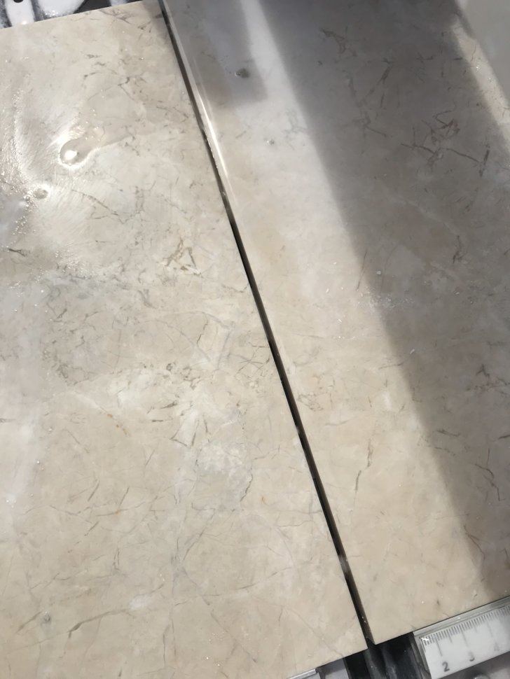

I have done hundreds of wet rooms. But not in quartz I have the big rubi table saw. I have tried plenty of water a new blade and an old blade and tried a marcrist ultra thin blade to and can’t stop it chipping the eges . The saw cuts all other tiles marble granite no problems
Can any body give me any tips please

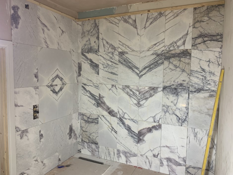

Tried all that and still chipped enough so I can’t use it the rest of the room in marble cut like knife through butter

Try montolit perfetto blade, it’s slow cutting through marble but leaves a very clean chip free cut
