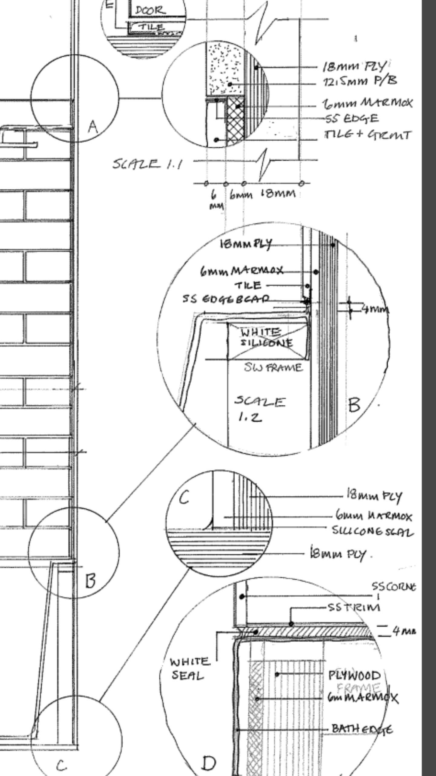

I just finished tiling the bathroom and ended up with a 10mm gap between tiles and bath (see picture) so now I can't decide what would be my best solution.
I thought to raise the bath but can't go higher or lower because of the panel size.
Any advice would be very much appreciated.

Raise the bath and have a "bang on trend" shadow gap at the bottom of the bath panel, maybe fill that with an LED light strip!

Thanks for the advice
Before I commit to unscrew and raise the bath is there any quicker option. What about pencil tiles or a bath sealant trim?

Thanks pdc.
I just removed the bath in the end. How much gap between the tiles and the bath should I leave? What about the silicon? Any advice before I fit it again.
You maybe have been able to use bath trim to hide the gap. There as to be a small gap to allow for silicone.
When you silicone, fill the bath with water then silicone, allow to cure and then empty the bath
