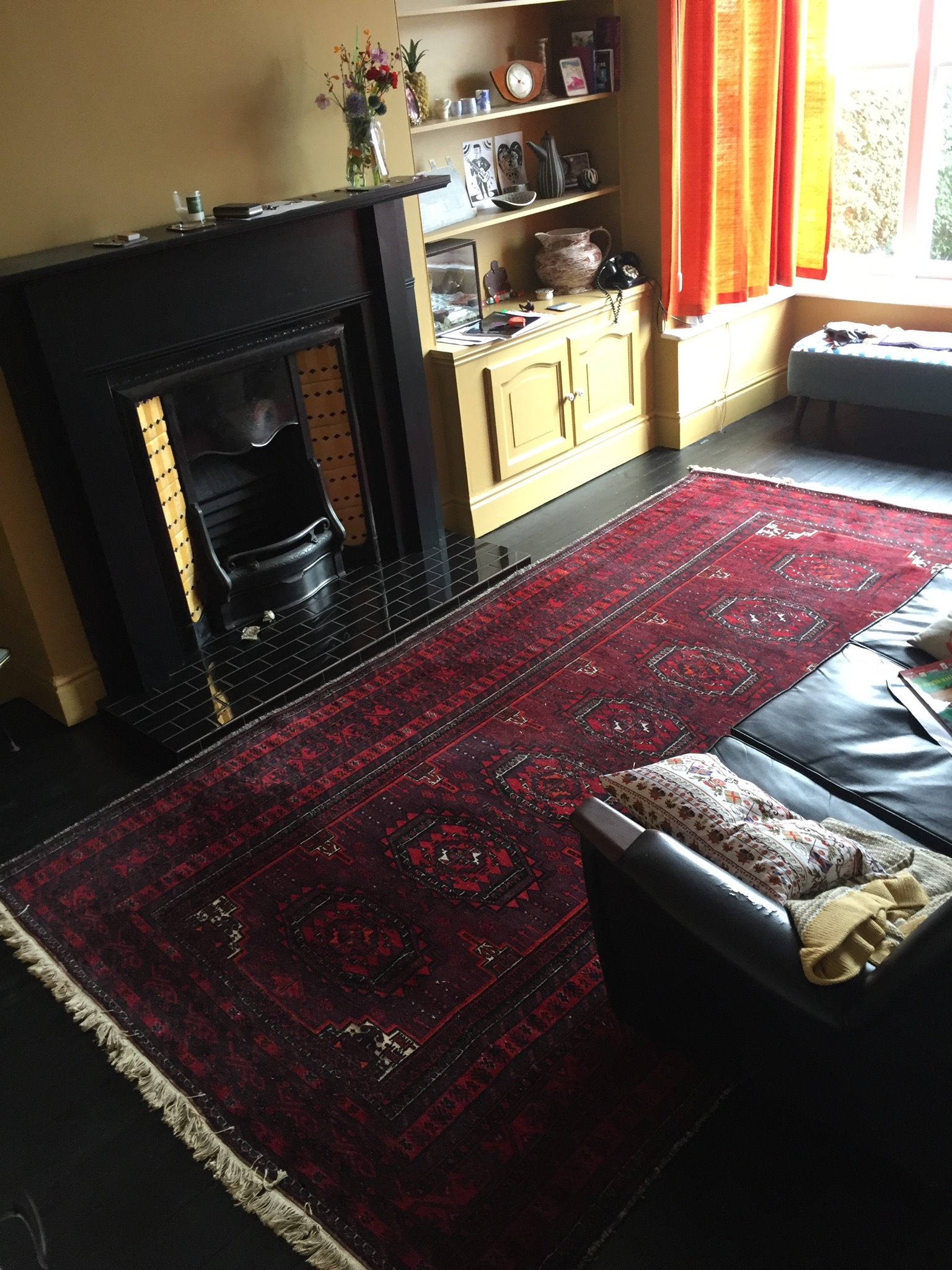

image.jpeg I had to do the same thing at home recently, got 3 prices of wood to make a basic frame then poured self levelling compound in to the require thickness. Take away the wooden frame and hay presto

I done this one with thermal board & slc.
I did the same with no more ply, but only because i was making it larger than the origional concrete area
That looks a nice job! The reason i was going with ply vs a concrete base was also due to the fact that i was making it wider than the original base. For me i still want the tile level to finish flush with the carpet so i just need to work out what size base i need for the 20x20cm 6.5mm thick tiles to sit on to line up with the carpet (prob 18-20mm total thickness) And looks like i dont necessarily need a word trim edge now :)
