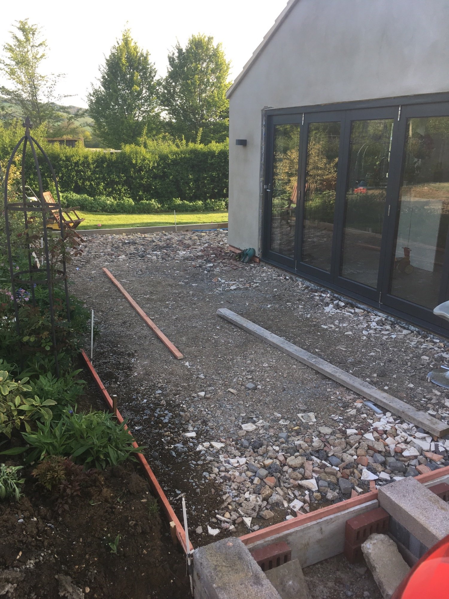

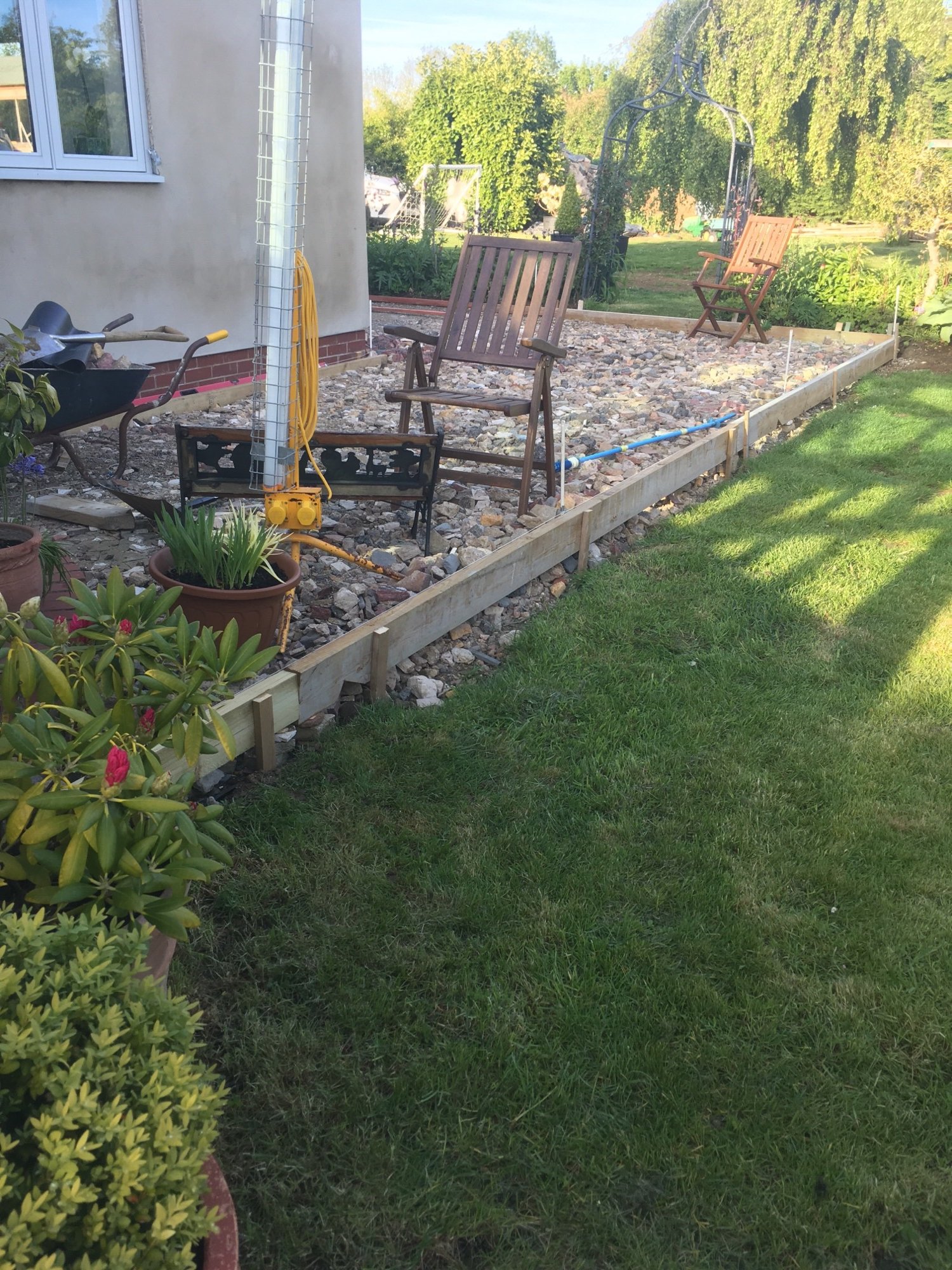

I've read and been advised by my tiler that the recommended method is to lay porcelain on a concrete slab which I'm preparing currently - which is 40 sqm - sqm on the front of a building and 20 sqm on the left so there is a right angle corner.
I've created a fall on the shuttering by using a long spirit level and made sure the bubble sits proud on the little line in the bubble window – sorry but I am a lay man – I hope this is enough fall!
My question is am I doing this right because what I’m worried about is when I pour the concrete it will sink to the lowest point.
Also due to access issues am I going to mix the concrete with an oversized mixer and wheel barrow it into place. In my simple mind I will do it in sections too, am I mad to do it this like this?
Attached are pics.
Thanks.

You’d be better off getting a ready mix pour and doing it in 1section on the side and 2 sections on the back - that way you will only have 2 expansion joints and if you work it out correctly get them in line with a tile joint.

Thanks for the advice but what I'm worried about is achieving a fall with the actual concrete rather than doing it with tile adhesive. Everywhere I look concrete slab are flat so am wondering if my strategy is going to work or not.

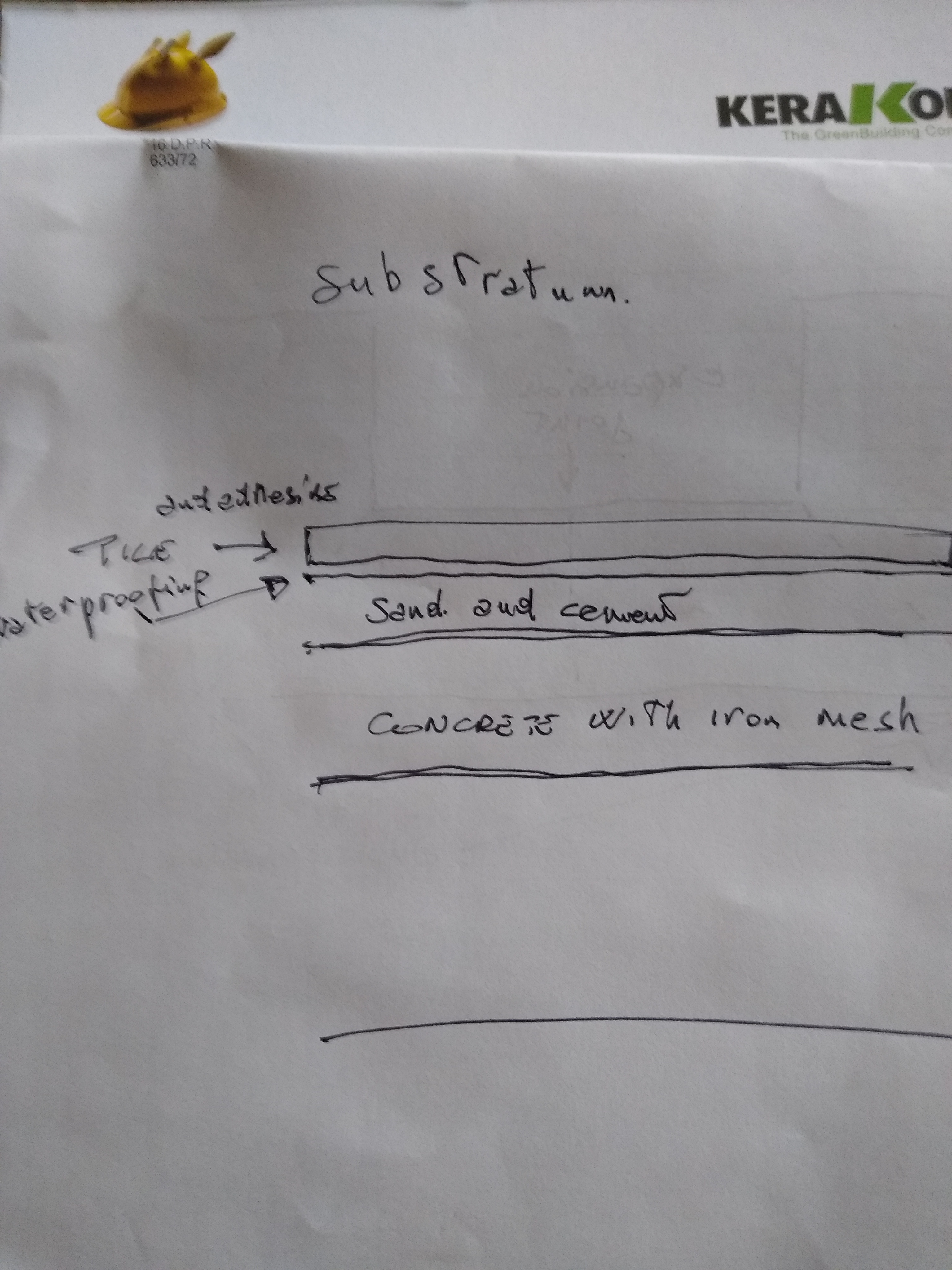

if I understand correctly,
do you want to glue the tiles over the concrete?
do you want to lay the concrete with the slopes for laying the tiles?
that procedure is not correct.
first you have to make the concrete with wire mesh armor
and after a layer of sand and cement with the correct slopes,
slope changes depend on the size of the tiles,
but the most correct thing is to take the corner of the house
and make a 45 ° cut

External tiling takes much more extremity's of weather than internal, a drainage/uncoupling mat should be incorporated under the tiles, it will cost more initially but will save you from a more than probable failure in a year or two and wasting £2-£3000 pounds worth of tiles in the long run.
Imo would be as well laying the screed level around 10-20mm lower than you need, and sorting out the falls with an external slc and fixing a mat like ditra drain before tiling.. As in Antonios diagram the 45 degree cut away from corners of the building will allow the appropriate falls to turn round the corners...
