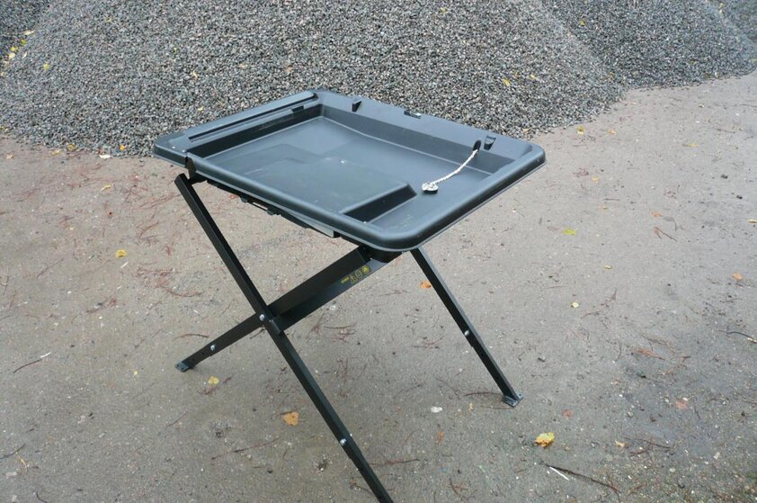

I have attached some pictures on the setting up of the cutter.

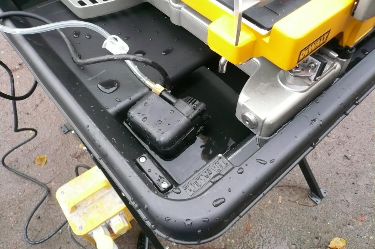

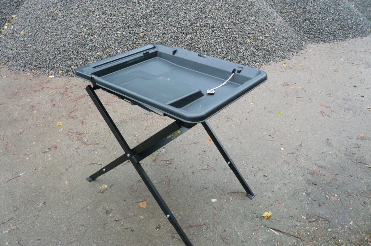

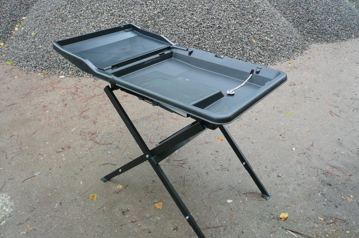

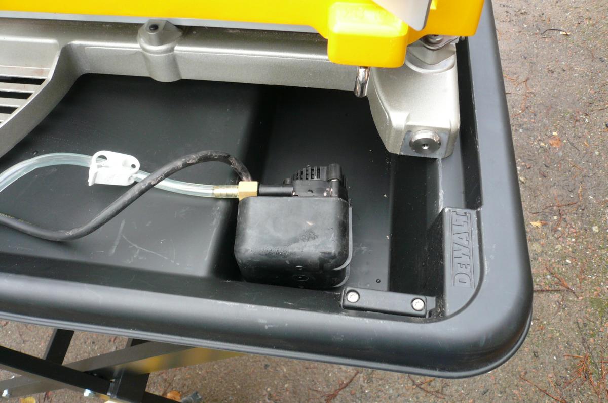

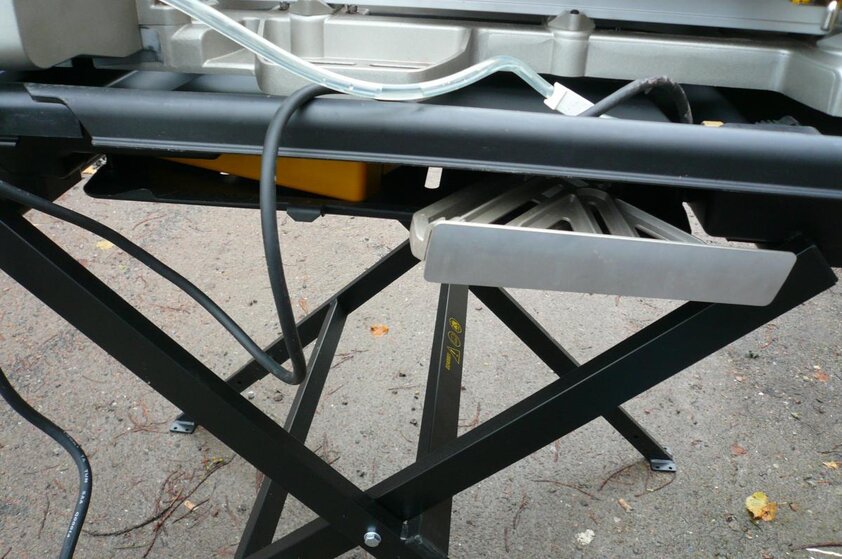

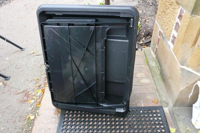

Dewalt have thought through this machine the water tray that the cutter sits on has a shelf to hold the table extension and the guide which are kept in lace with a small bungee. The main tray and extra water trays all pack together with a handy clip that stops them coming apart.

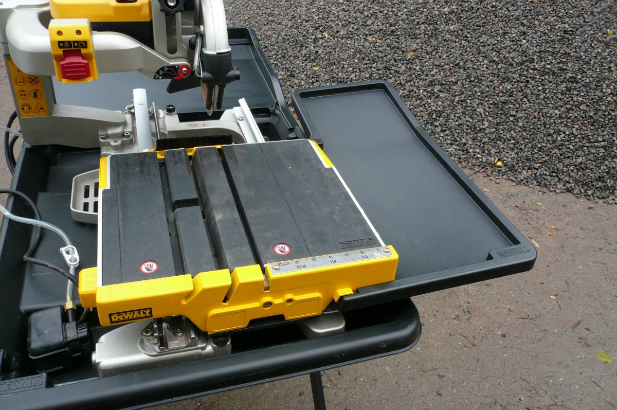

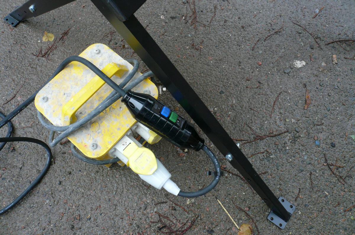

Now onto the cutter the machine is alloy and stainless the table section locks into place when in transit undo the snib and you can remove the table completly ideal for cleaning. The table can be adjusted if there is any problem with the cutter running out of true , it has a very good sliding action. The cutter also has an rcd connected to the cable as standard.

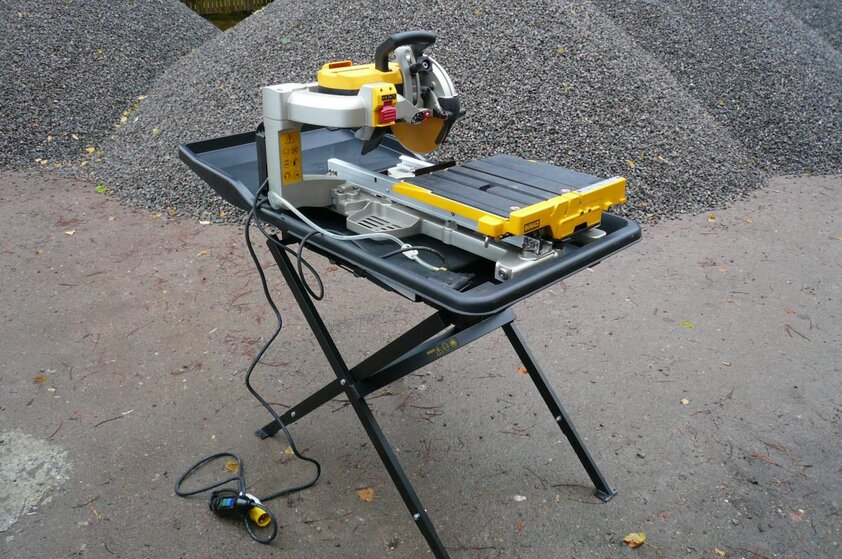

The head on the cutter is adjustable great for plunge cutting the table has slots in it for 45 and 90 degree angles which is extremly acurate and very stable. The cutter has a great blade and has cut 55mm flagstone as well as Victorian tiles.
I used the cutter for cutting 2mm of some Victorian tiles nice clean cuts straight lines this saw is ideal for cutting geometrics.
The water feed comes from two tubes that can be moved onto the blade for best feed, the feed can also be restricted by a clip attched to the water pipe, this allows for less spray. The majority 98% of spray is caught on the extra water trays one that attaches to the main tray and the other attaches to the saw table.

The saw is very easy to set up and very easy to clean down. If you purchase one it does need the stand that is normally an extra. It is a very solid and thought through machine. The saw is ideal for all materials and ideal for mitres and geometrics.
