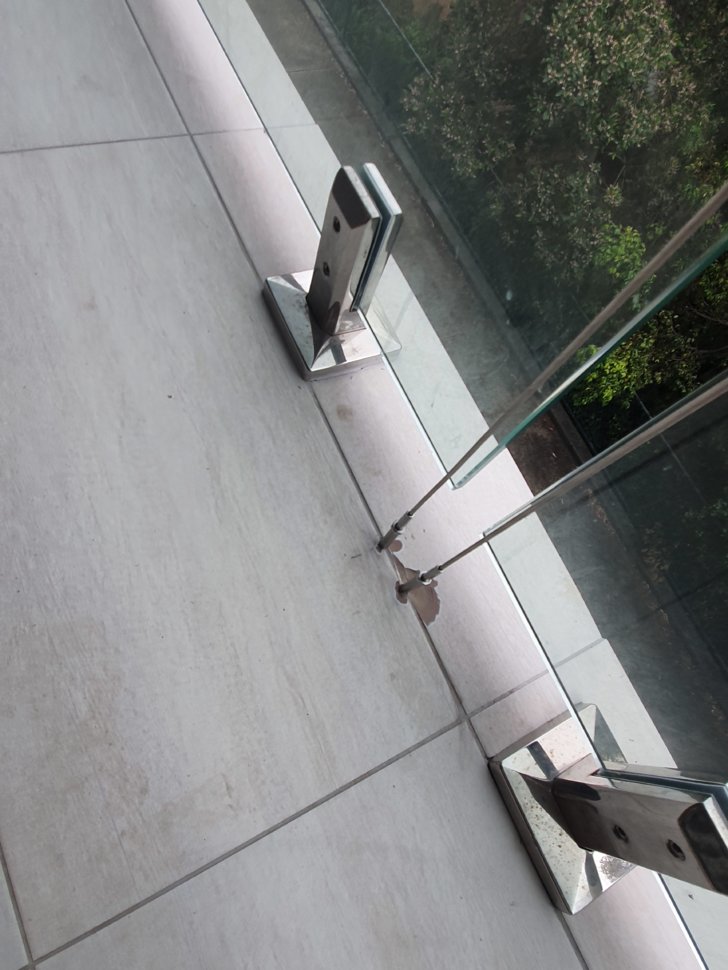

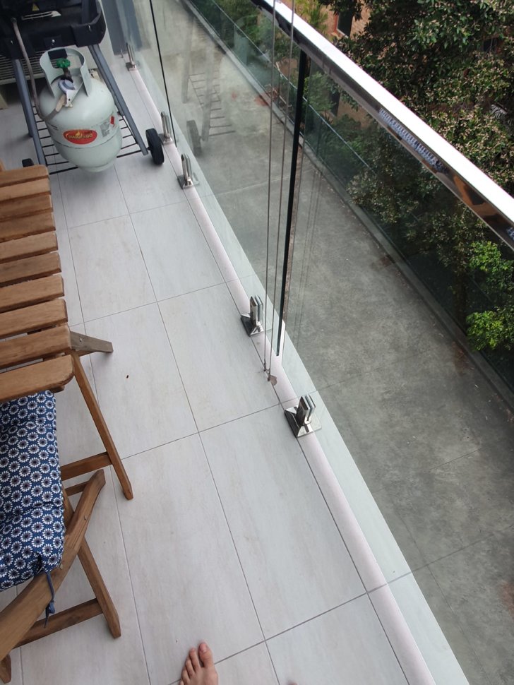

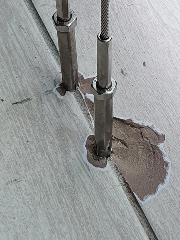

We recently had awnings fitted to our balcony, as you can hopefully see from the photos the balcony is tiled with porcelain tiles. To attached the guide wires to the balcony floor, the installers drilled the tiles and then hammered a slightly expanded pin into the tile. During the hammering, the tiles significantly chipped (as you can see from the photos), unfortunately, then carried on and did this to all of the tiles. There was no prewarning that this was a risk, the person that came to quote had seen what the floor tiles were. In the eve, when we wound the awning up, one of the six pins just popped out.
I’m not a professional, but in my opinion, they should have drilled the tile, secured some sort of anchoring into the floor and then screwed the fitting in. It would have been much more secure and wouldn’t have popped out.

- I’m am going to ask for the tiles to be replaced (we have spares), do see any other way to fix this?
- How realistic is it that then can remove a tile that close to a glass balustrade?
- How do you think these should have been secured to the floor?
