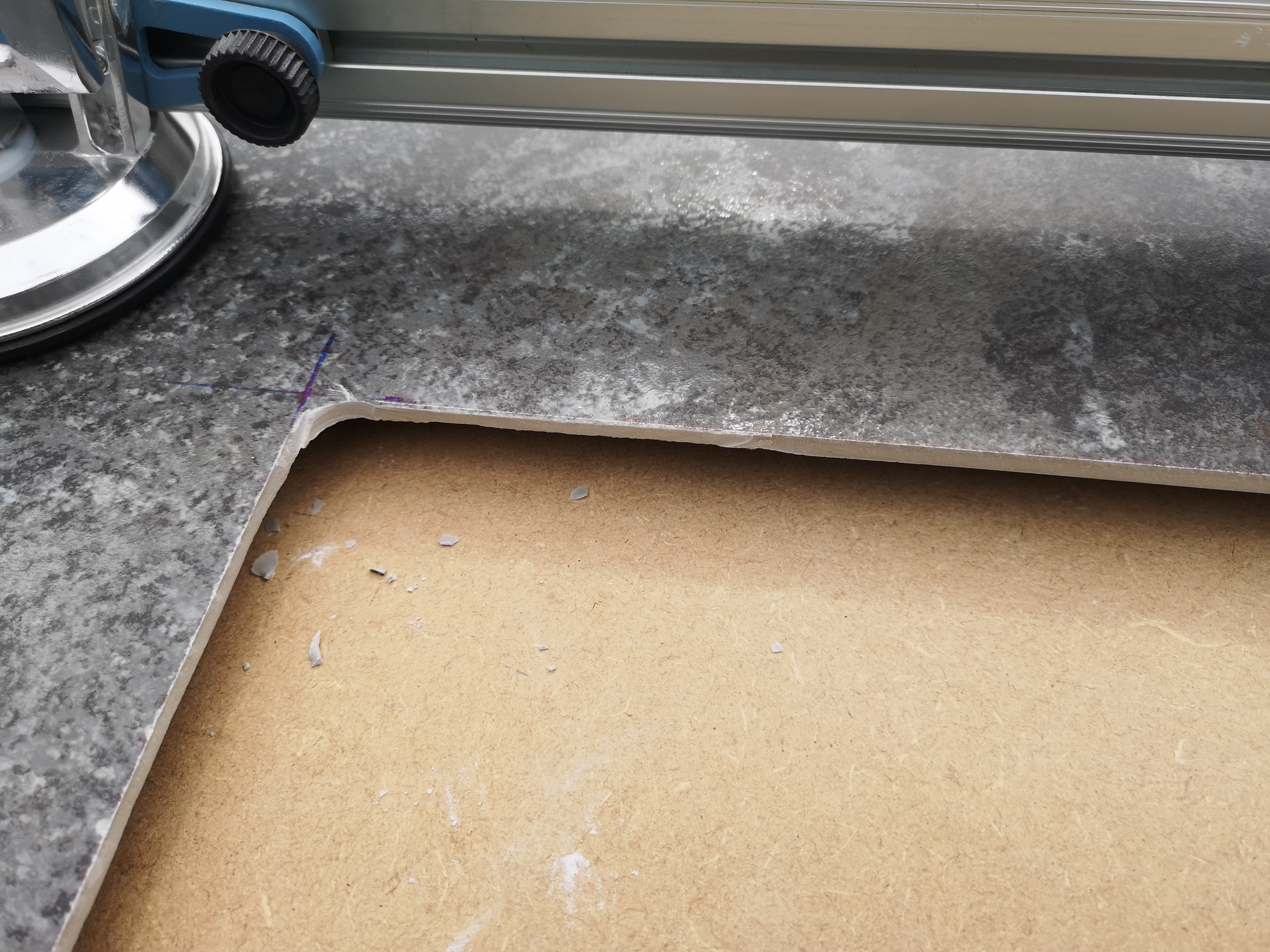

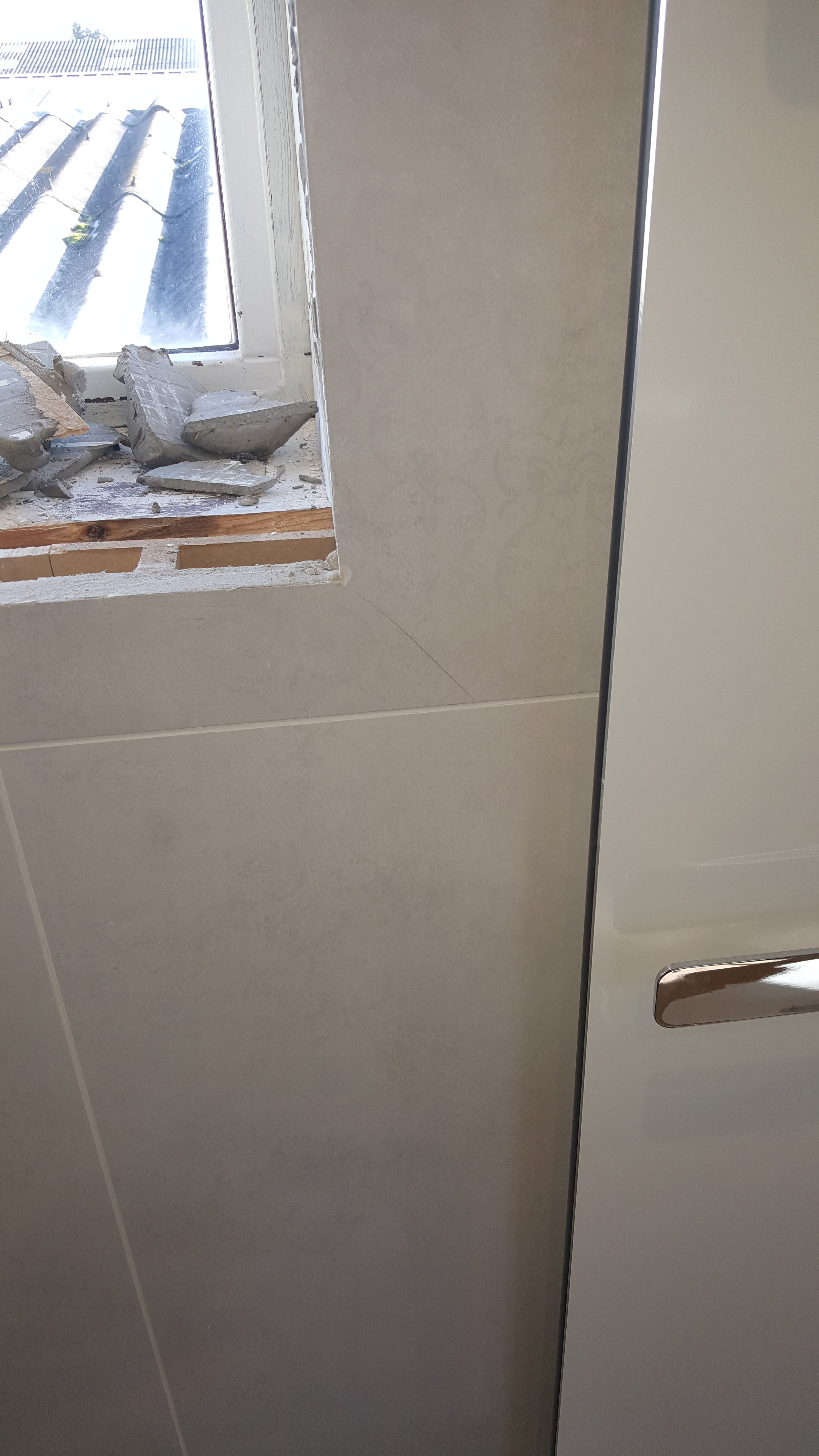

Apparently so, it relieves tension in the tile and stops it cracking.Do you have to drill holes in XL tiles before cutting a piece out for example round a door .
I've seen some YouTube videos and they all show this method
Thanks I thought that but wanted to get confirmation if it's necessaryApparently so, it relieves tension in the tile and stops it cracking.
But I’ve only ever heard of it on the internet, never seen anyone do it in real life and never done it myself .
it is dangerous to cut and mount a xl without drillingThanks I thought that but wanted to get confirmation if it's necessary
XL?Do you have to drill holes in XL tiles before cutting a piece out for example round a door .
Is 6 mm hole okXL?
Not pre drilling a corner opens you up for a potential breakage.
Thro experience I can assure you it increases your chance of a successful install when you pre drill corners.
If you have a sharp 90 degree corner, any stress on the left or right side can cause a fracture, effectively you’re creating a start point.
Whereas if you form an arc, there is no actual starting point for the fracture.
Don’t be lazy, increase your chances of only cutting a tile once.
Drill that corner.
