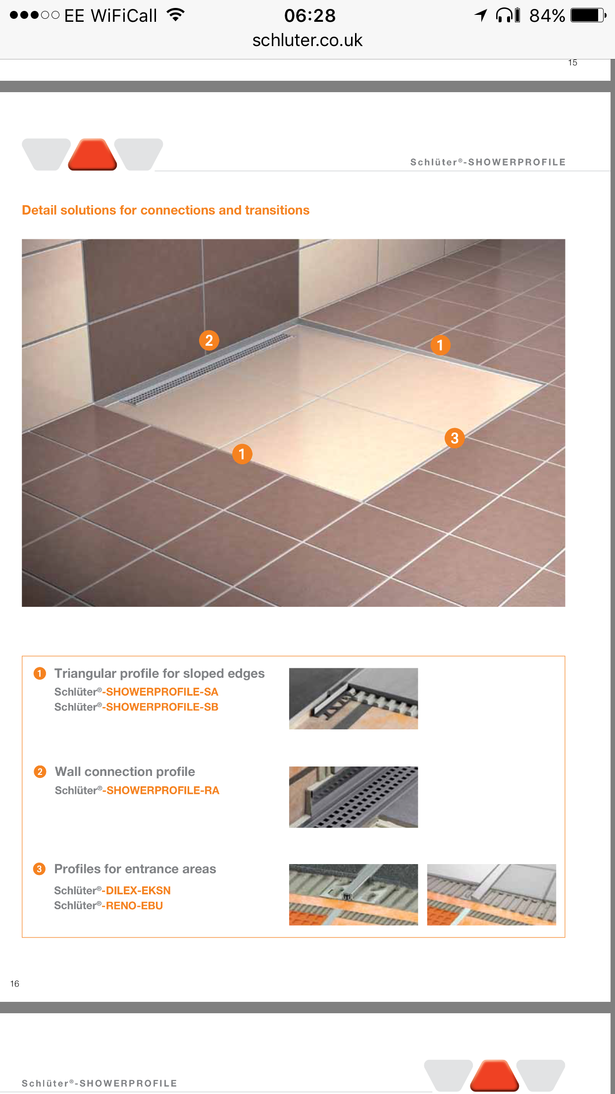

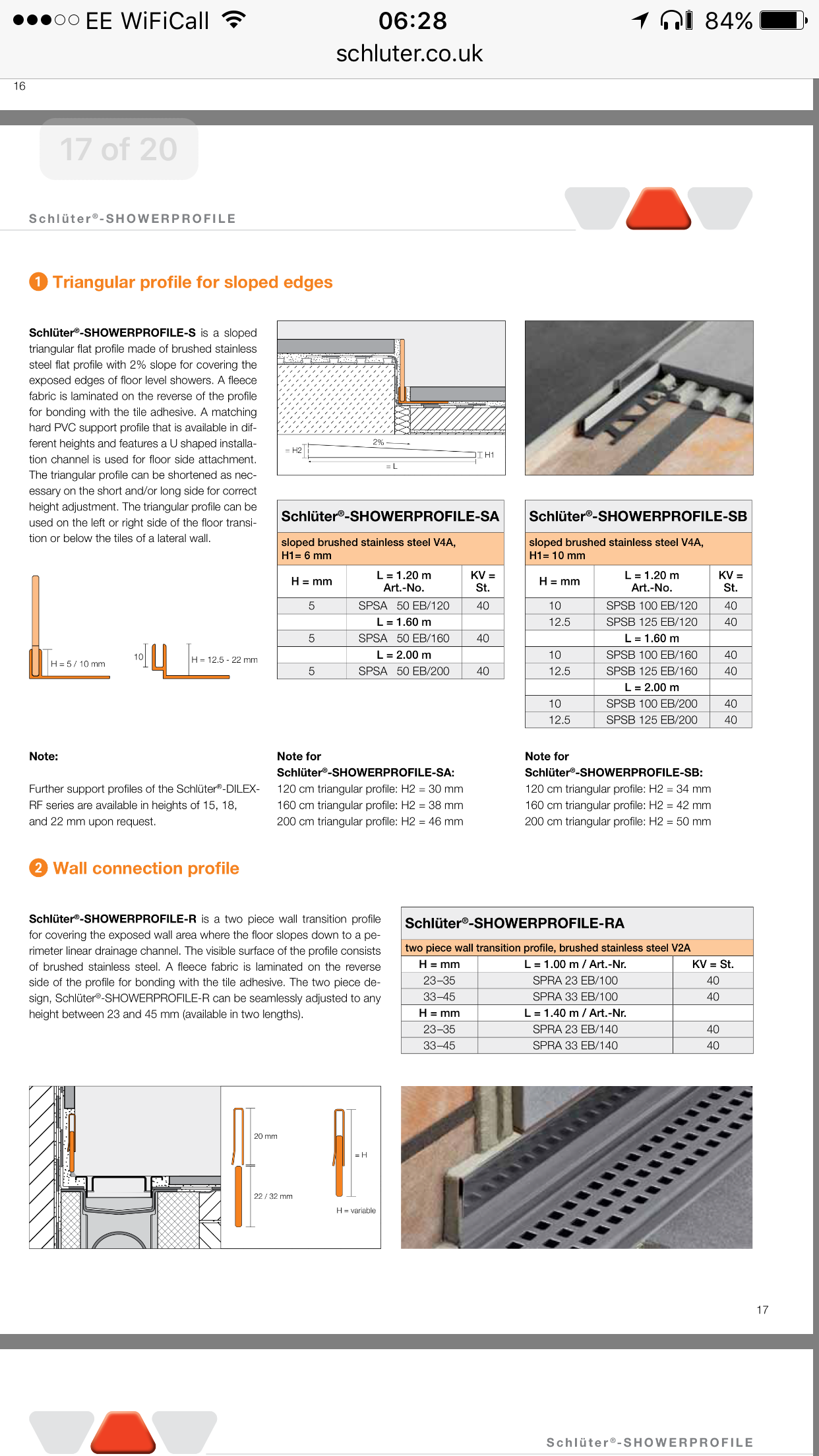

I've started a bathroom refurb & the current plan is to install a curbless 1200 x 900 shower with a single plane fall into a slot drain along the back. Wall on two sides, and a glass screen on the third.
I have no idea how to deal with the sliver along the bottom edge of the glass screen as I go from the floor height at one end of the shower to c.28mm (Assuming 1:40 fall - is this correct?) at the slot drain end. You can see the issue below; what's the best way to detail the triangular sliver of a wall? Is there a T-shaped trim I could turn on it's side or something?
As an FYI, there'll be one long wall with hexagonal tiles and a niche shelf like the below, but we'll have large format rectangular floor tiles. The niche shelf will have a concealed cistern in it, so I'll make the 'lid' of the shelf removable for maintenance. Any useful tips on the best way of going about this?
