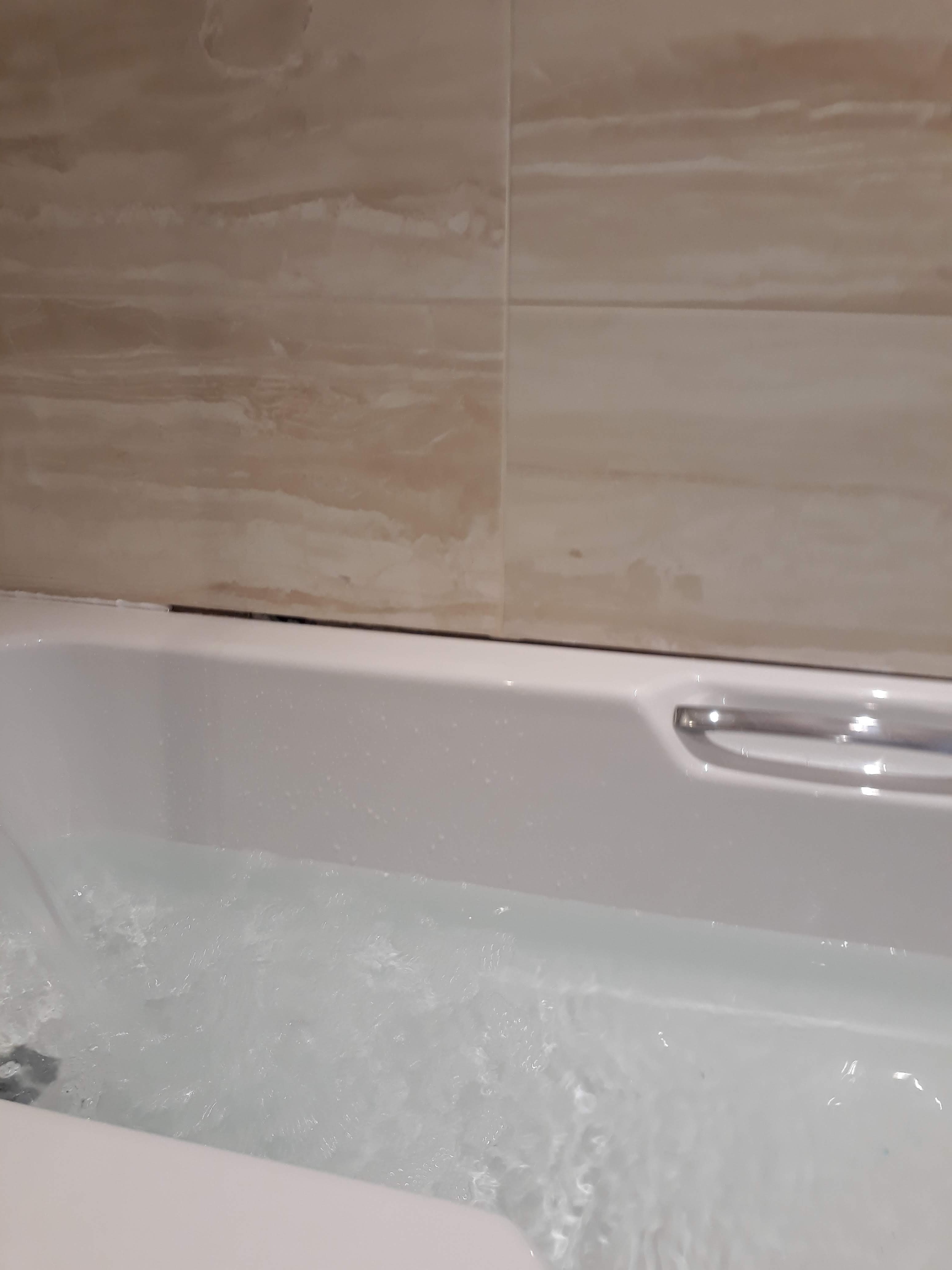

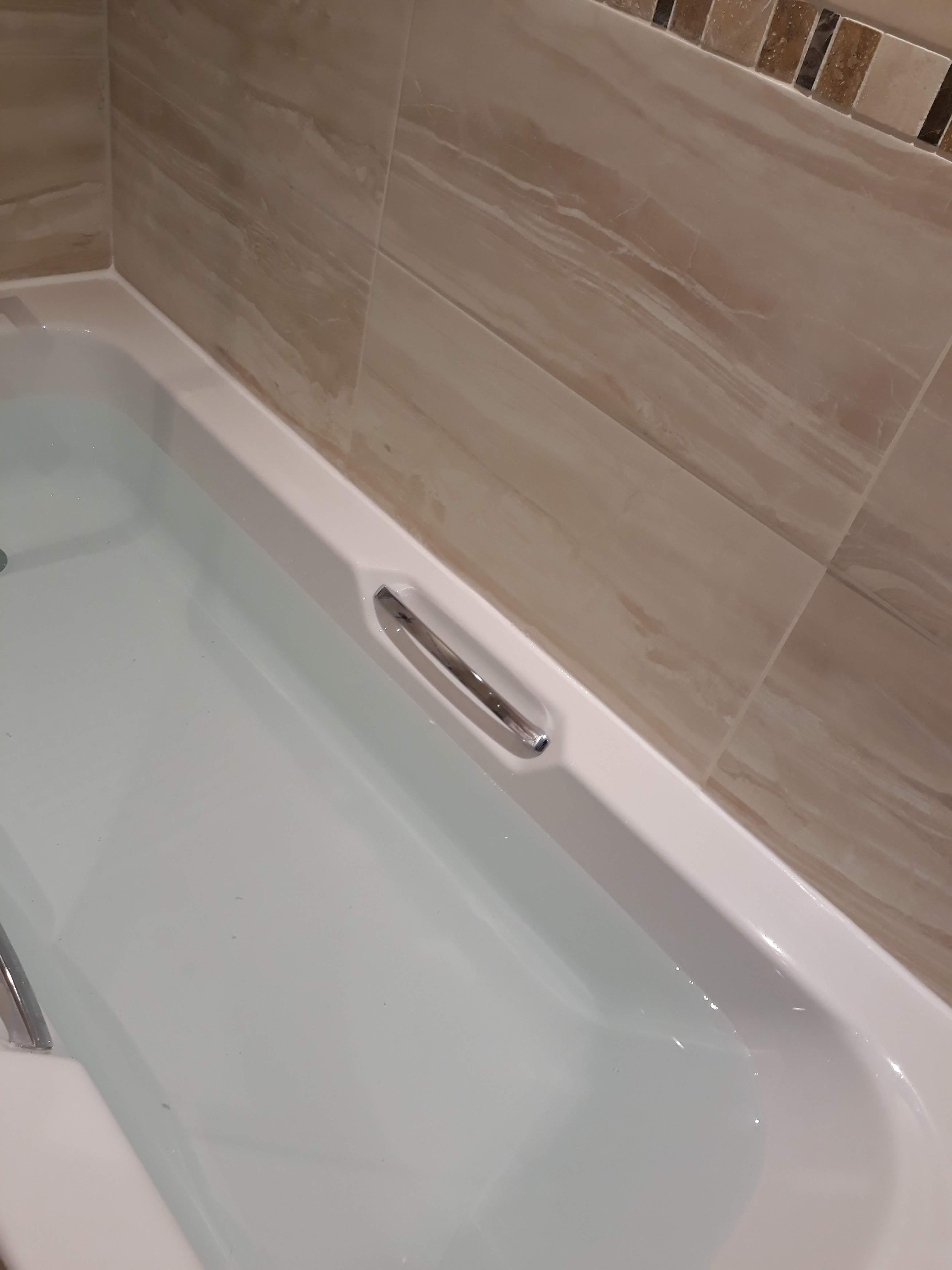

Well it's a case of raking the cracked grout out removing all the debris before using a quality sanitary silicone even if there are different gaps and thicknesses that need filling you can still get a satisfactory finish I did some in a hotel recently where they had a similar problem with movement of the baths fill the bath with water whilst carrying out the work and leave it full until fully cured . Cheers kop
