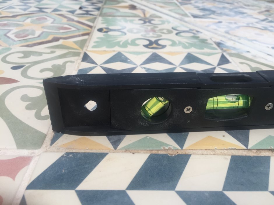

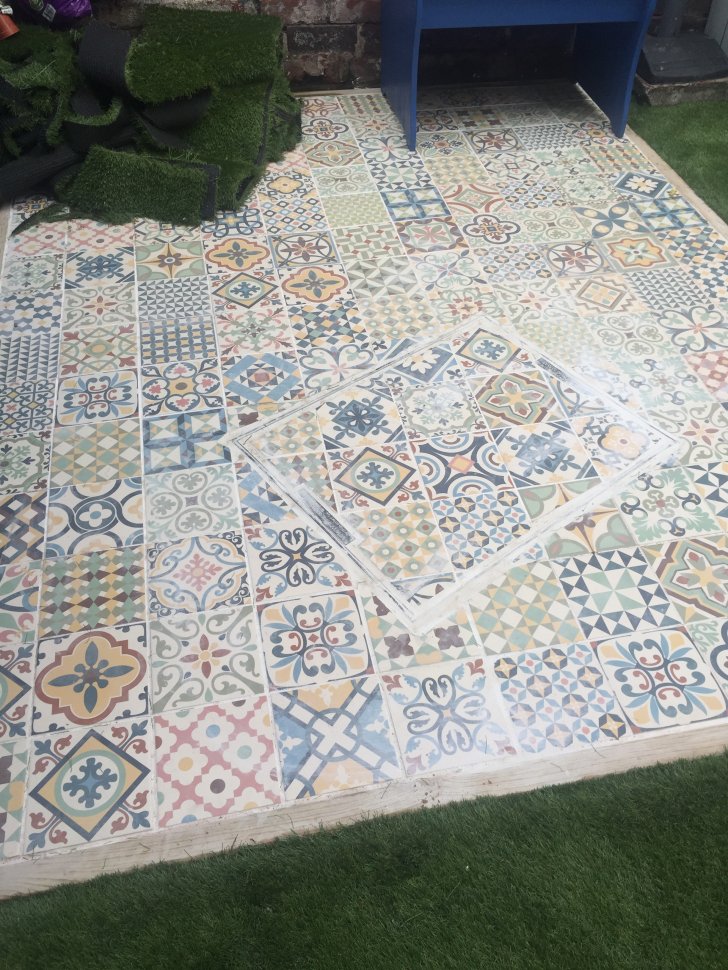

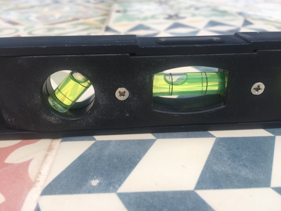

We hired someone to do a small outside patio using porcelain tiles. They finished the job whilst we were away since they went way over their original estimated time. Now we’ve returned from our holiday, I’m really disappointed and don’t know if I’m being really picky or being taken for a mug 🤷♀️
I had some concerns when they were laying the tiles because it was taking them a long time and they were using an awful lot of https://www.tilersforums.com/forums/tile-adhesive/ yet it didn’t look like it was going on particularly evenly. We had agreed we would buy materials like https://www.tilersforums.com/forums/tile-adhesive/ and grout after running it by them. I had initially purchased 40kg of rapid set white flex https://www.tilersforums.com/forums/tile-adhesive/ upon their advice but when they ran out they went out to purchase a different brand grey https://www.tilersforums.com/forums/tile-adhesive/ saying it wouldn’t make a difference. They ended up using nearly 140kg of https://www.tilersforums.com/forums/tile-adhesive/ for a 6.5m2 patio.

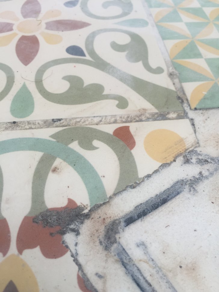

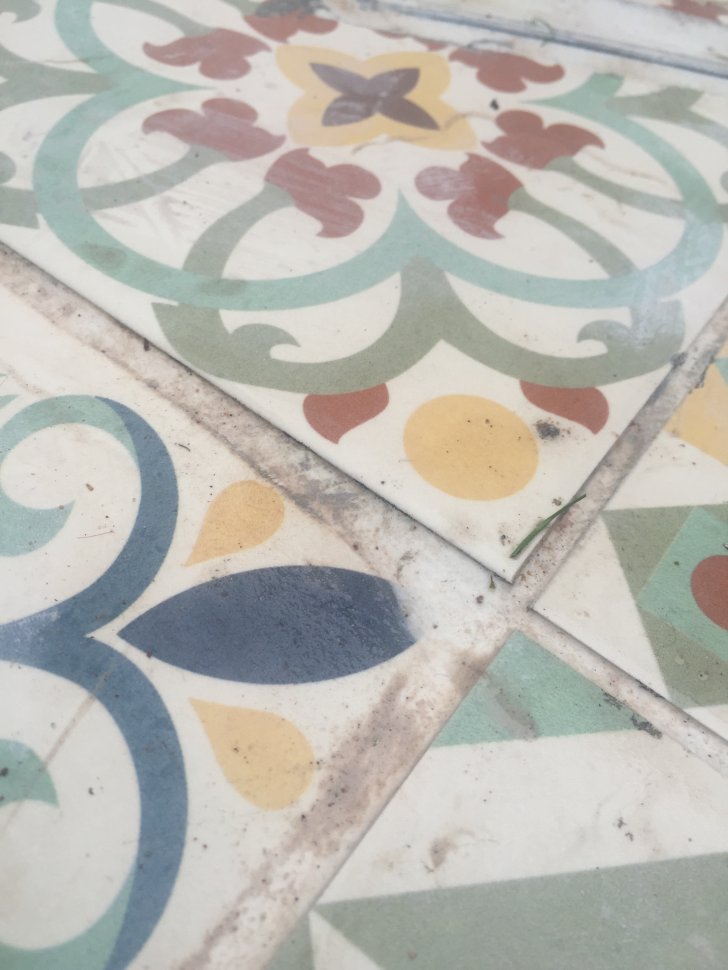

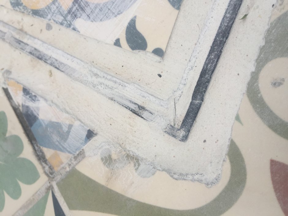

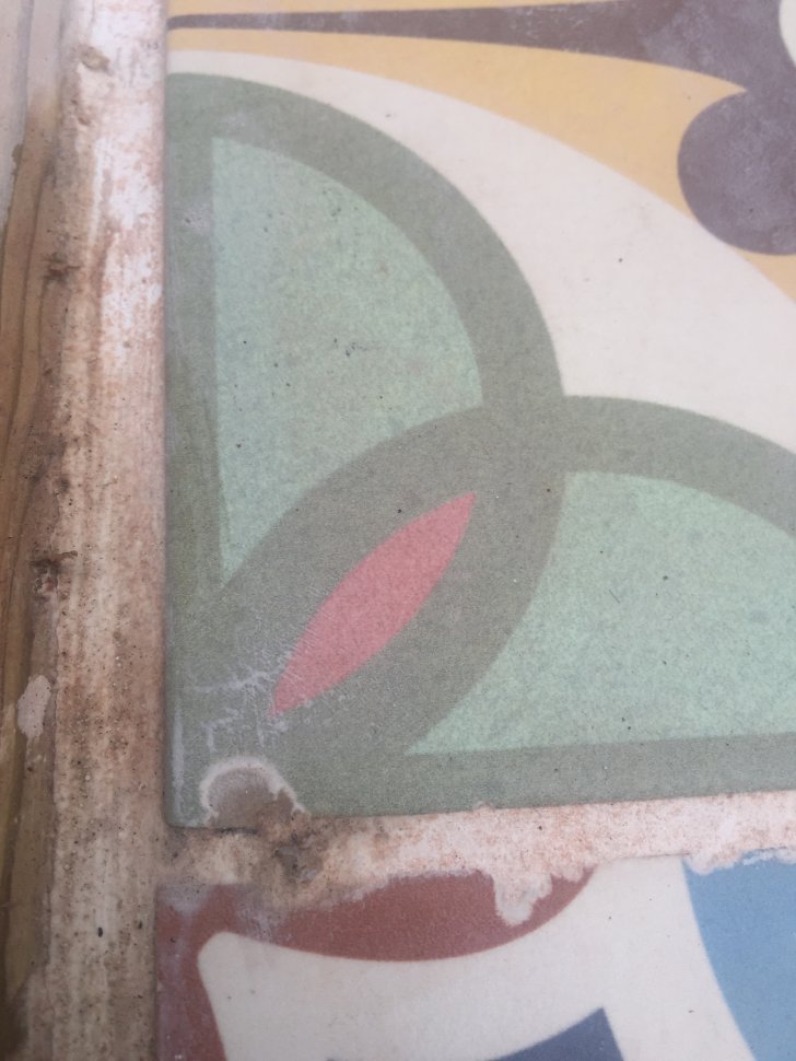

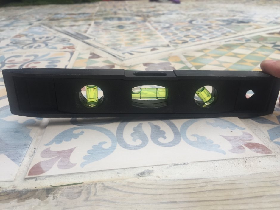

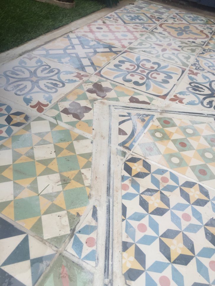

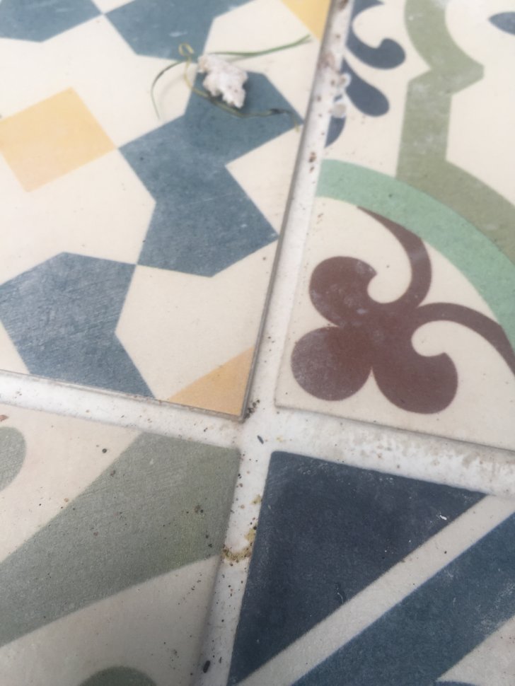

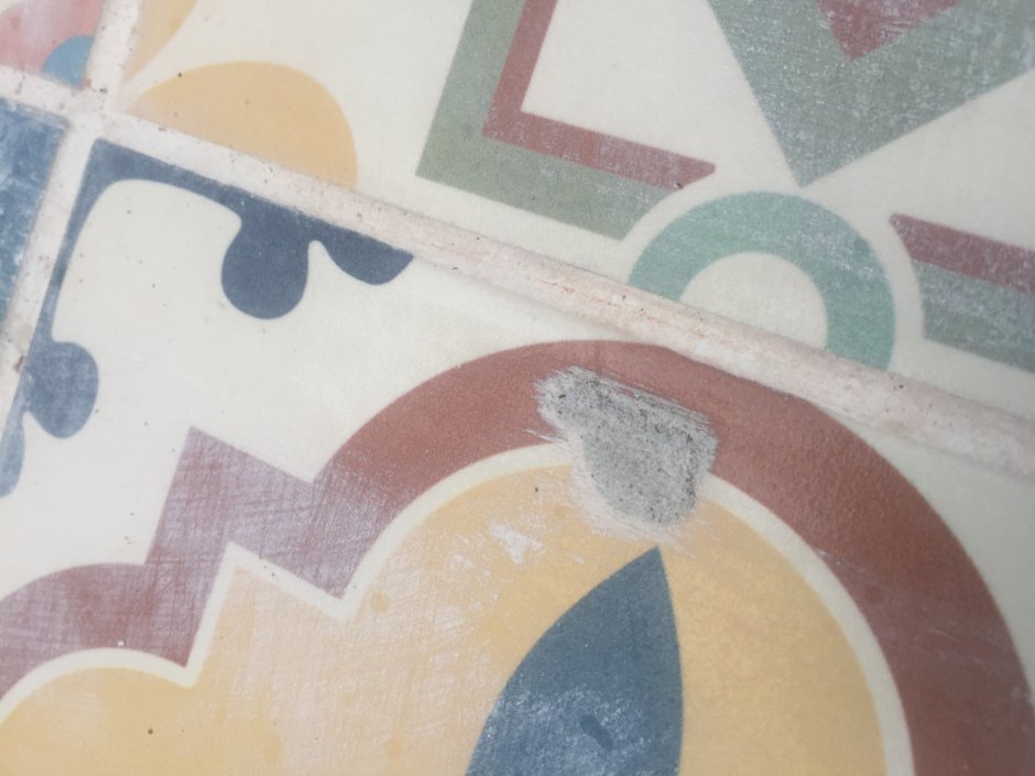

The tiles are visibly uneven which is also noticeable underfoot. Some of the cuts look particularly bad especially around the recessed drain cover. Some tiles are obviously chipped despite the fact we had ordered plenty extra and have lots of unused tiles left. I might be being daft but I can’t see a way to lift drain cover as it looks like it’s been grouted in. The grout seems uneven and shallow in some places but then overlapping the edges of tiles which are significantly low/ dipped. The tiles and grout look messy with grey https://www.tilersforums.com/forums/tile-adhesive/ marks dried onto the tiles and grouting, along with discolouration of the grout with sand and artificial grass blades grouted in.
Just looking for some professional opinions as to whether this is a standard job or if I should be as concerned as I am. Thanks in advance guys 🙏
