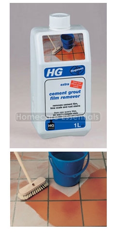

I have used both the Lithofin and Hg products to remove grout residue. Both have a wide range of products suitable for most jobs. The last one i used was Lithofins Wax-off on a job a previous tiler had left grout on the surface of the tile (the tiles were a nightmare like sand paper). First try it on a spare tile to make sure its not too strong and ruins the tile and if its alright i sponged it onto the surface and let it soak in for ten minutes before scrubbing with a scotch pad. After srubbing for a while it looked pretty clean so i then washed a couple of times and let it dry. On this particular job when it dried there was still small patches of grout so i repeated the same steps again and it came up spotless.
Cheers
19
cement_grout_remover1.jpg give this a try
