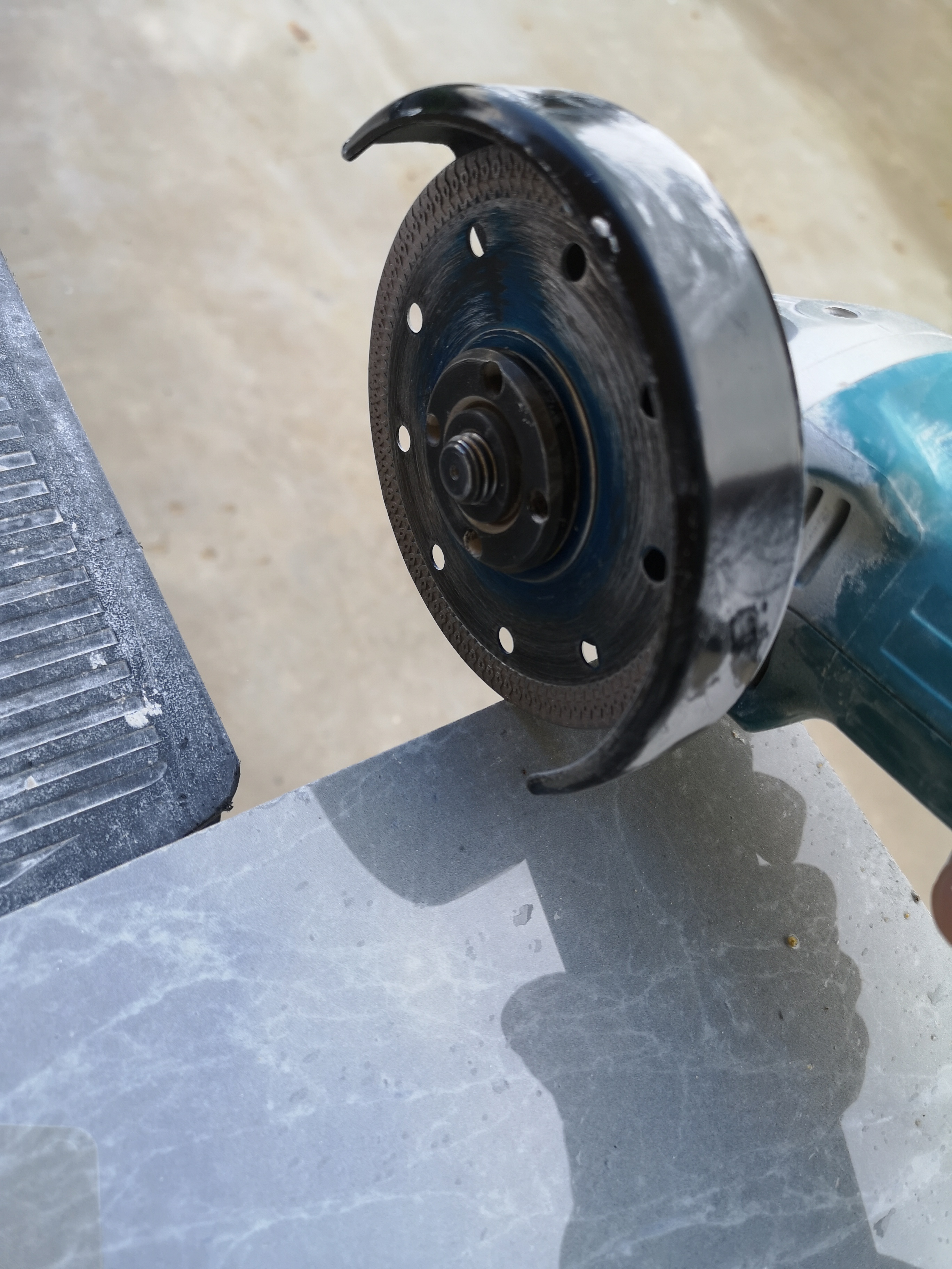

B
Bill
This is what I do, the pencil line is to my right, so I just follow that with the blade cutting in the same direction.

Bill
Never see one used like that Tom 😲
Safest way with two hands - no debris flying upwards towards my face and the dust goes away from me too. Any kickbacks are controllable with ease.
I don't understand why any of you would cut against the rotation of the blade - surely this can only stress the blade and motor.
