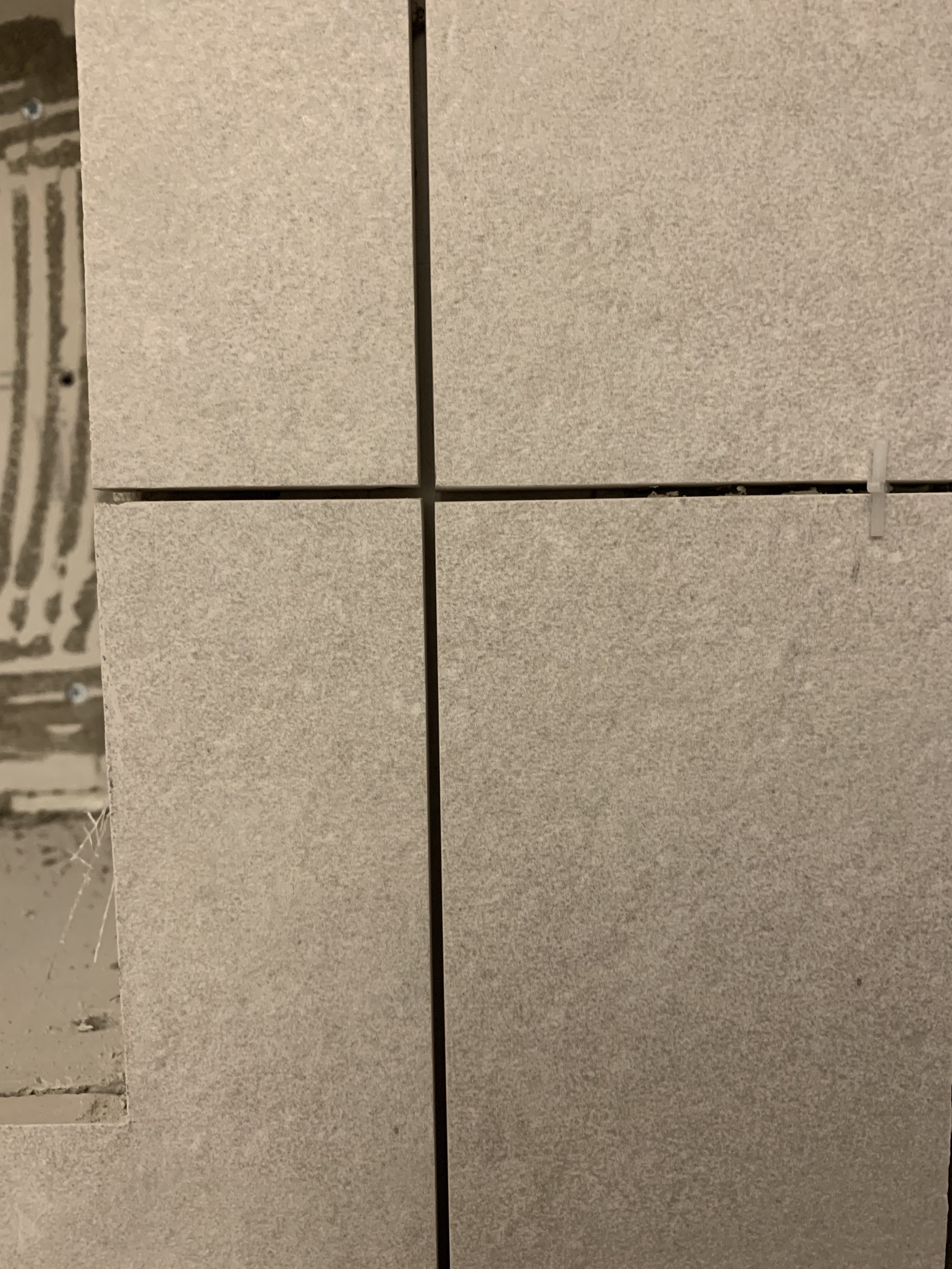

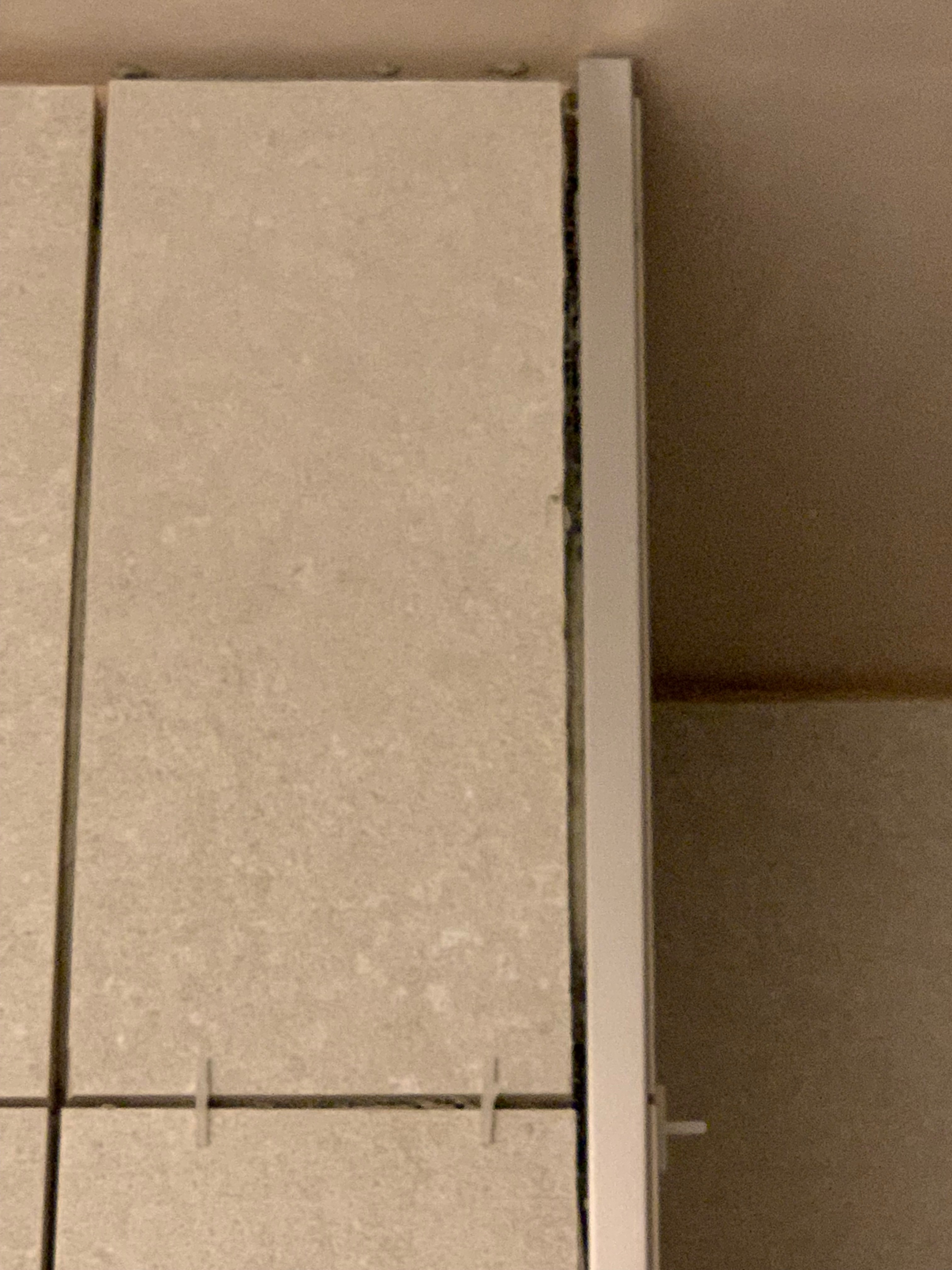

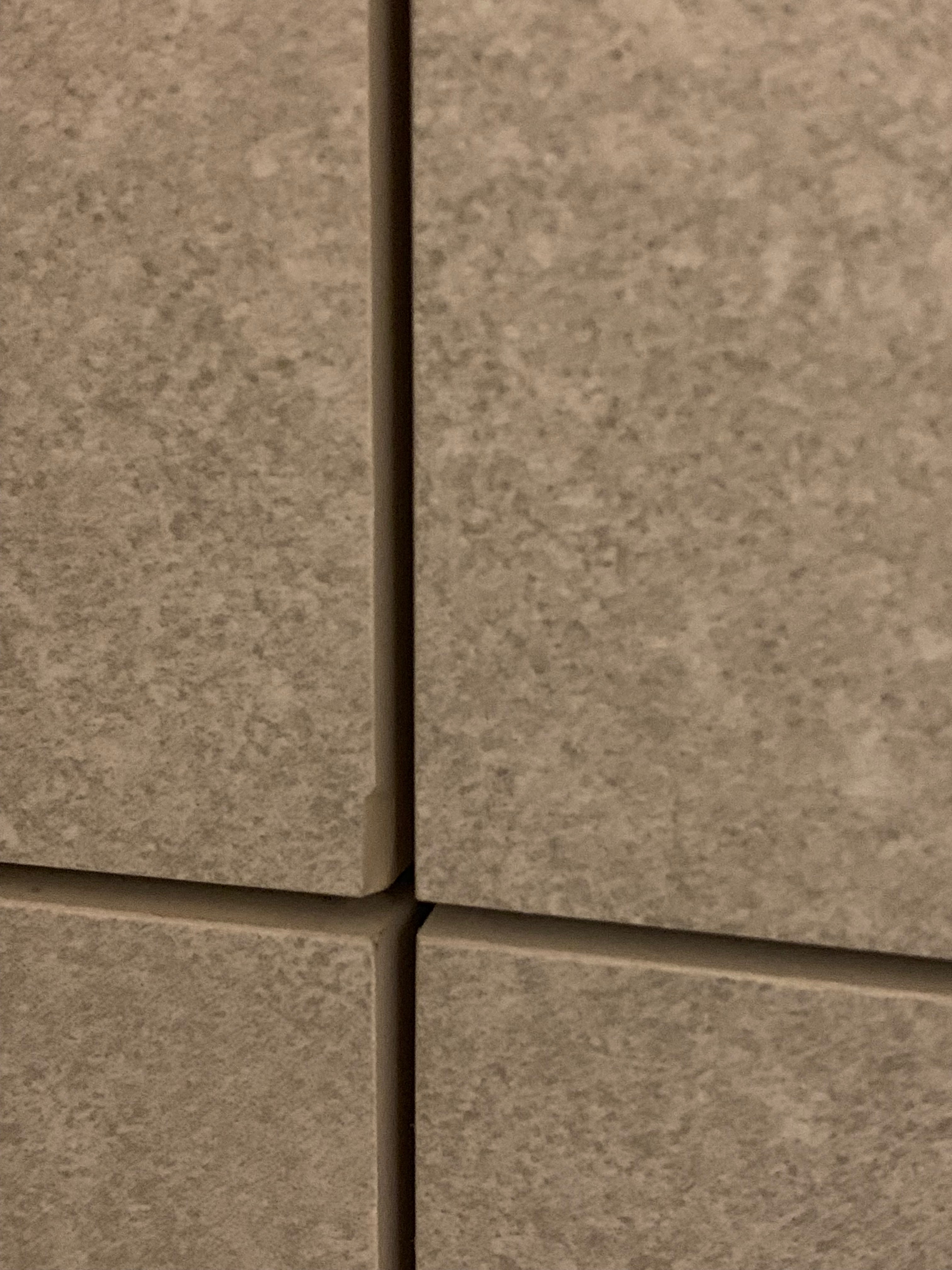

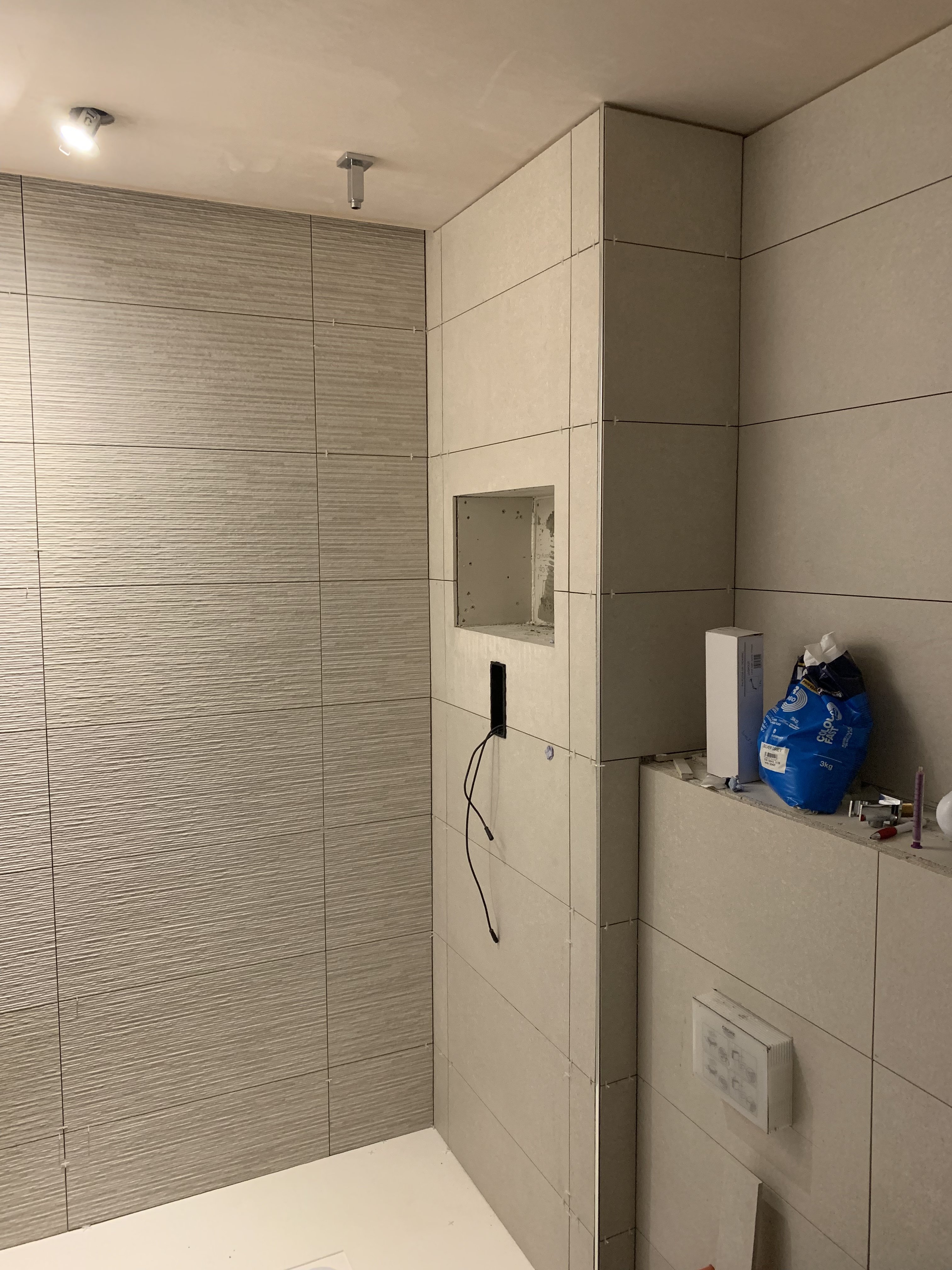

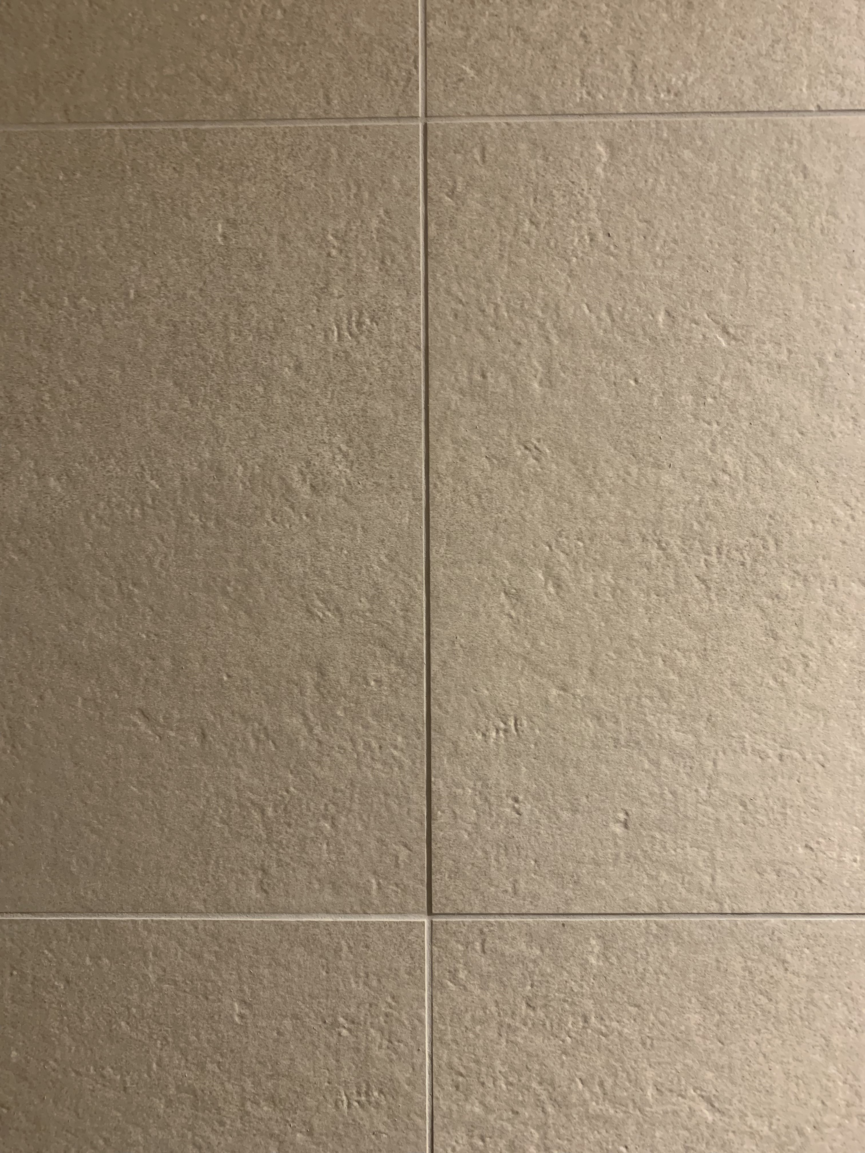

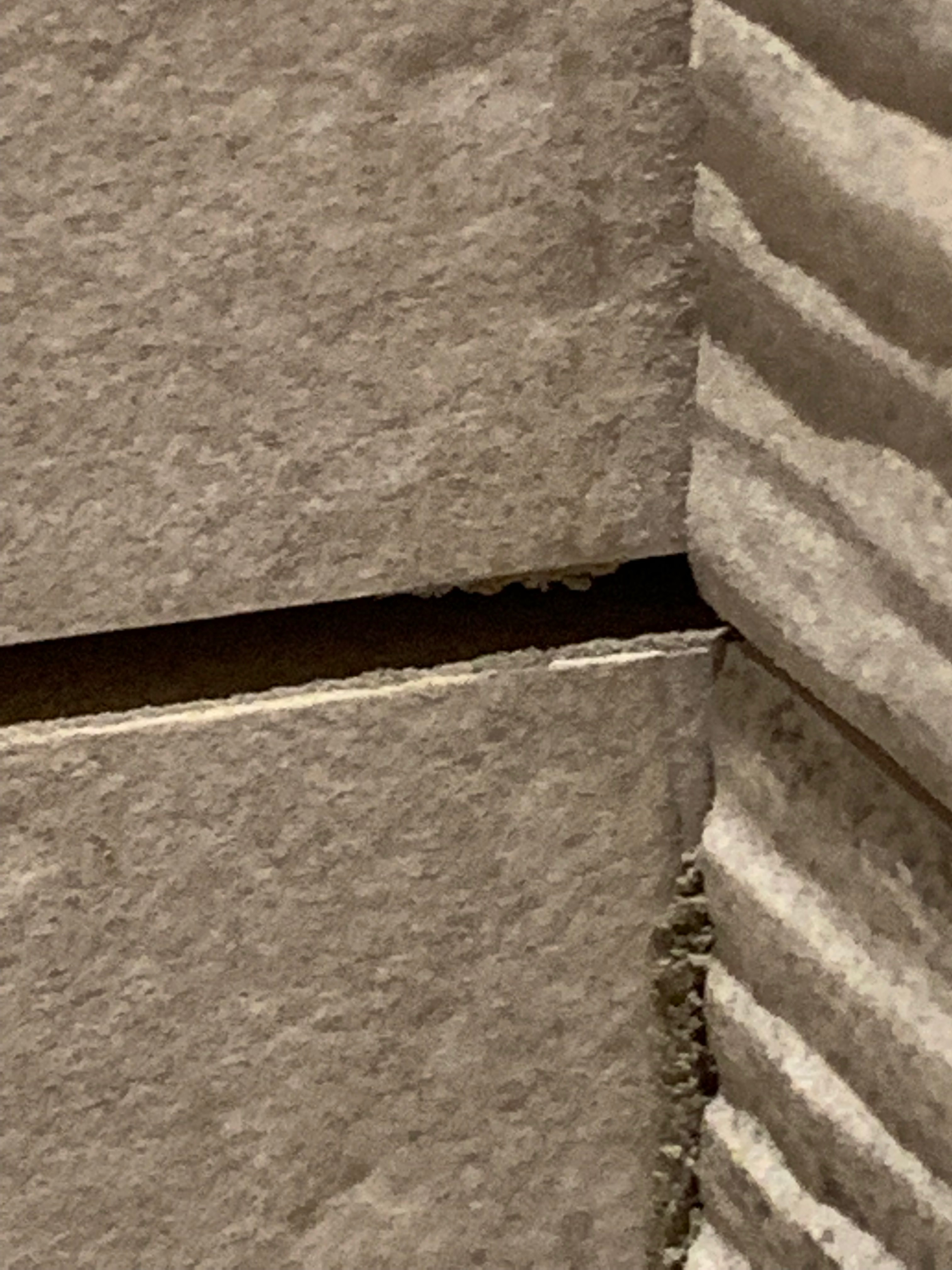

It looks to be a little sloppy in places, but it’s certainly not terrible.

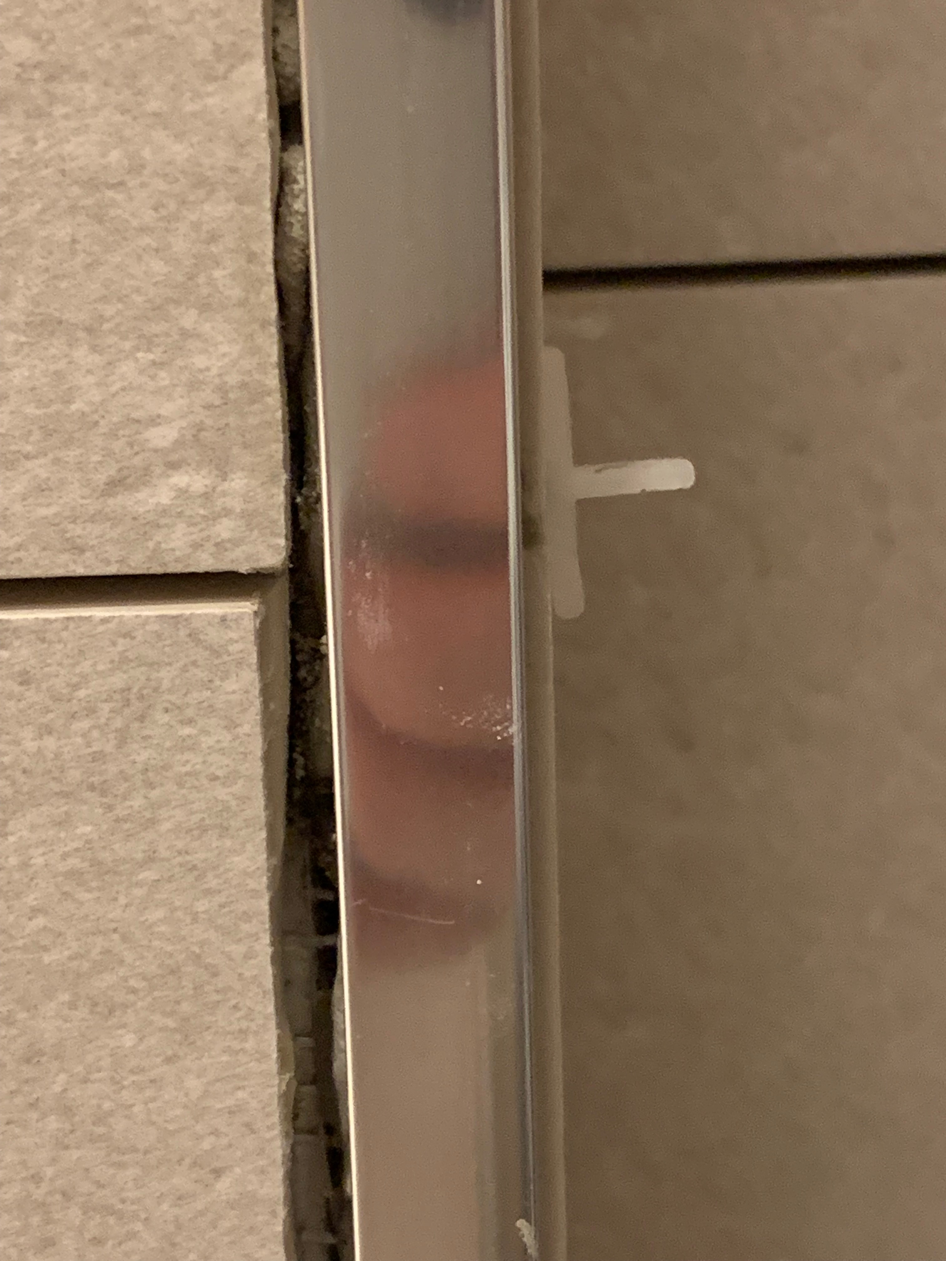

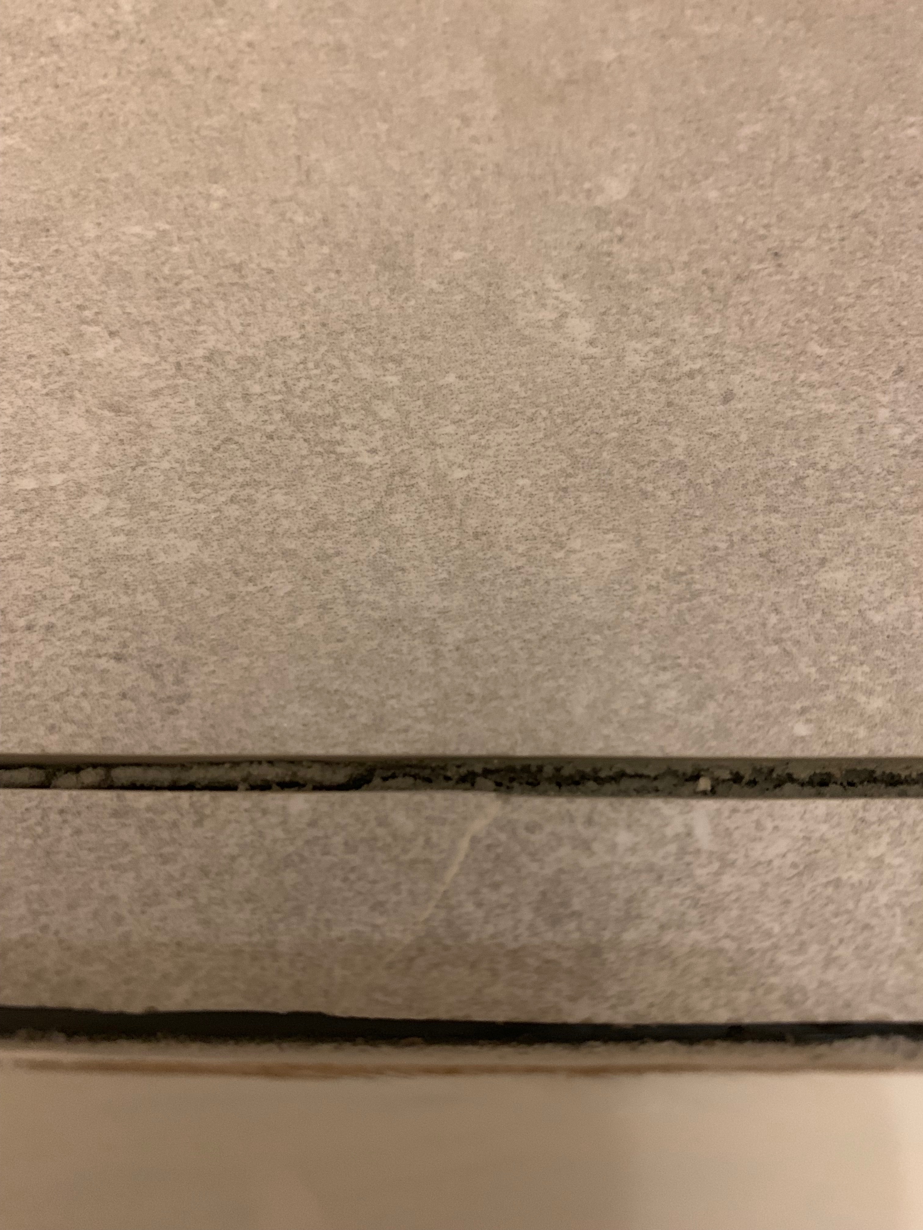

It looks like the trim needs to be replaced with a bigger one and the cuts redoing into it, but as your pictures are so close it’s hard to tell.

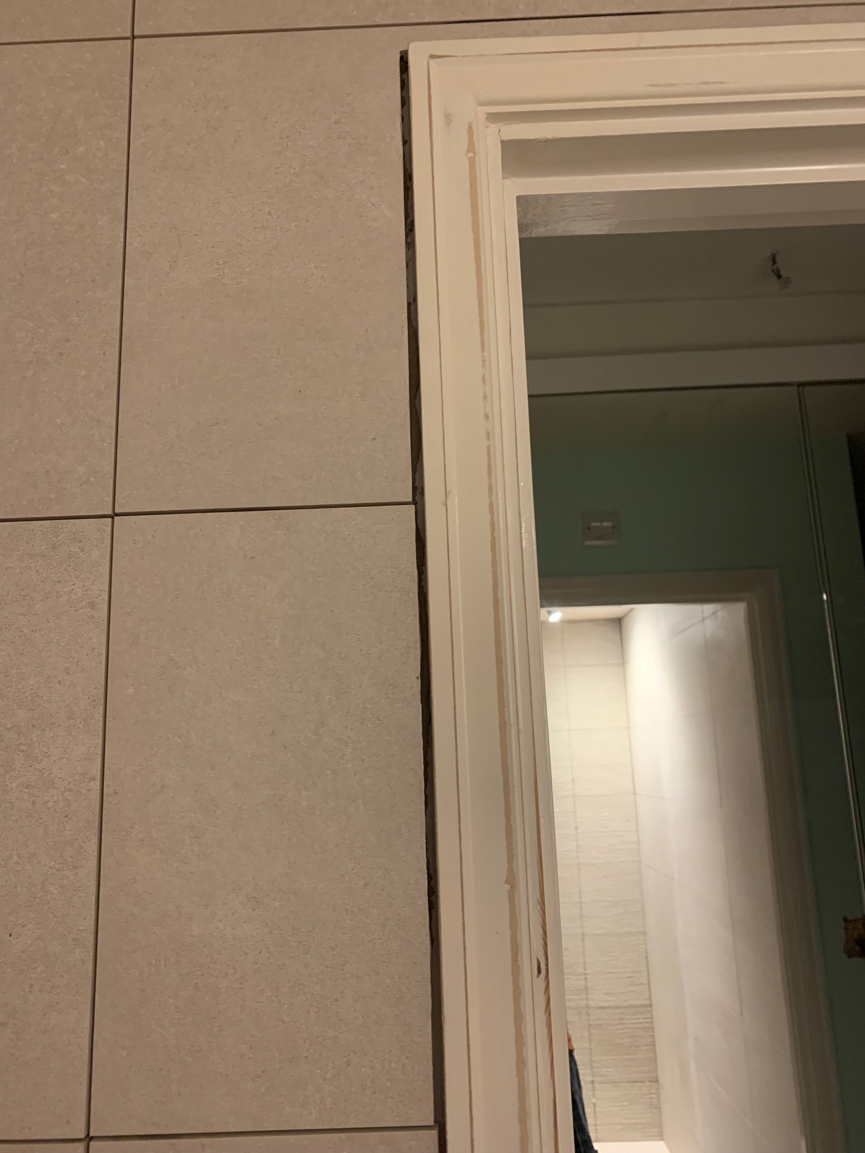

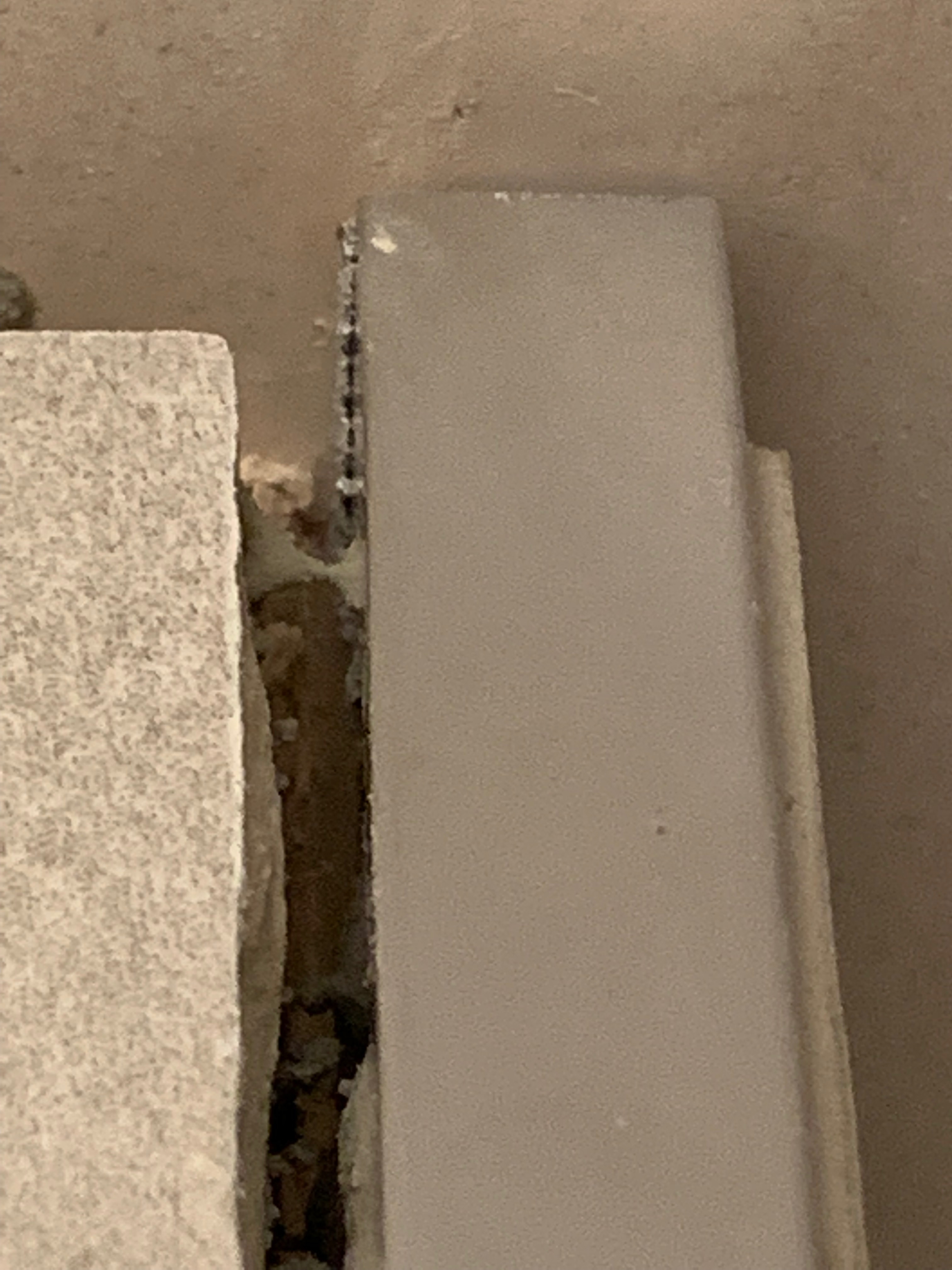

And the same with the cuts round the architrave are a bit shy, but there would need to be 3mm or so anyway.
Who was responsible for the prep?
What kind of response are you hoping to get?
Speak to your tiler and highlight your issues, I’m sure they can be remedied easily.

The builder didn’t as I said I would pay the tiler extra to do it but the tiler said it wasn’t needed as it’s aquapannel boards. I even bought knauf scrim and joint adhesive for him to use but he didn’t touch it after asking him to.Did they tank the wet areas?
