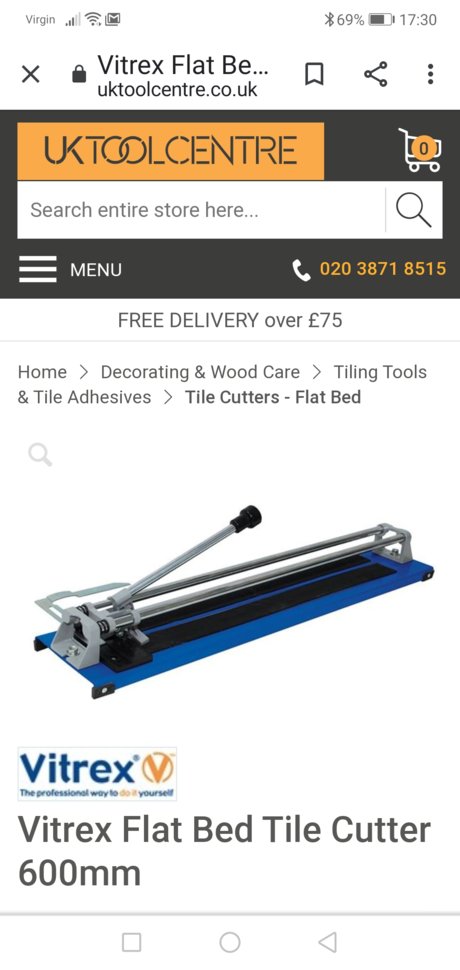

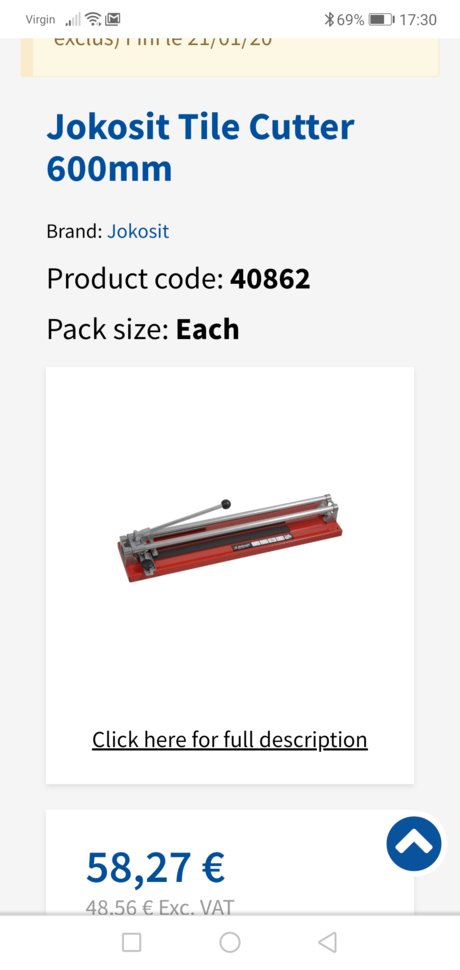

Hi guy's go easy in a newbie here 1st post I live in a council house and have decided to lay tiles 9mm ceramic in the kitchen as I will be wasting my time and money on a council property I still would like it to be tidy. This is a one time job only so I have to buy a cutter at least 600mm long I've seen a couple of cheap ones vitrex and josokit after the job is done it will be left to die in the shed so will this be OK for a one off job or is there something better for around the same money as those 2

Never used those brands (and doubt anyone else on here will have). If they are ceramic tiles then they will probably be okay, but if porcelain then definitely NOT.
