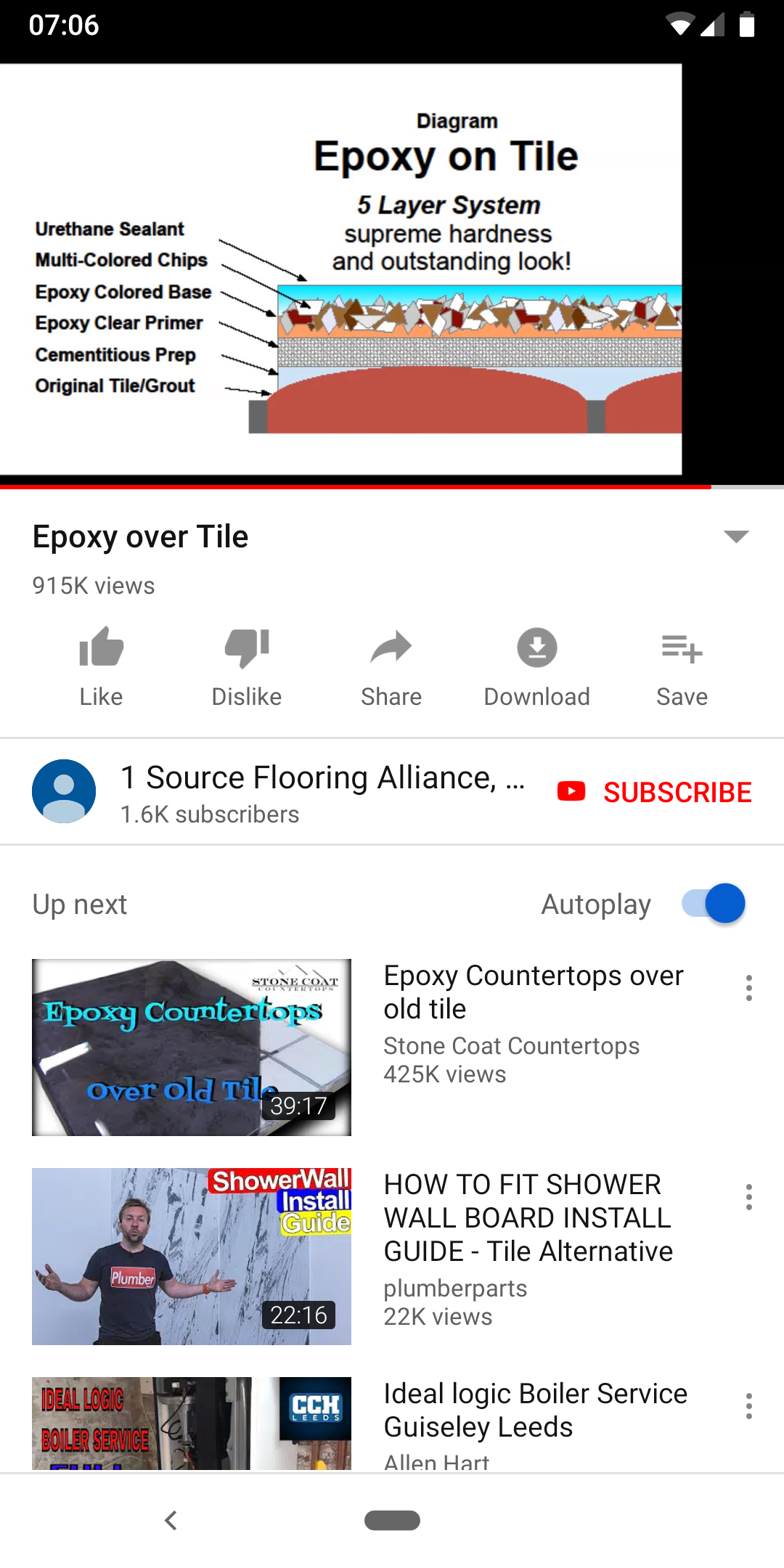

There is a clip on you tube showing floor prep over quarry tile for a expoxy resin floor . Kop

pcm77
you sir are a legend..exactly what im looking for

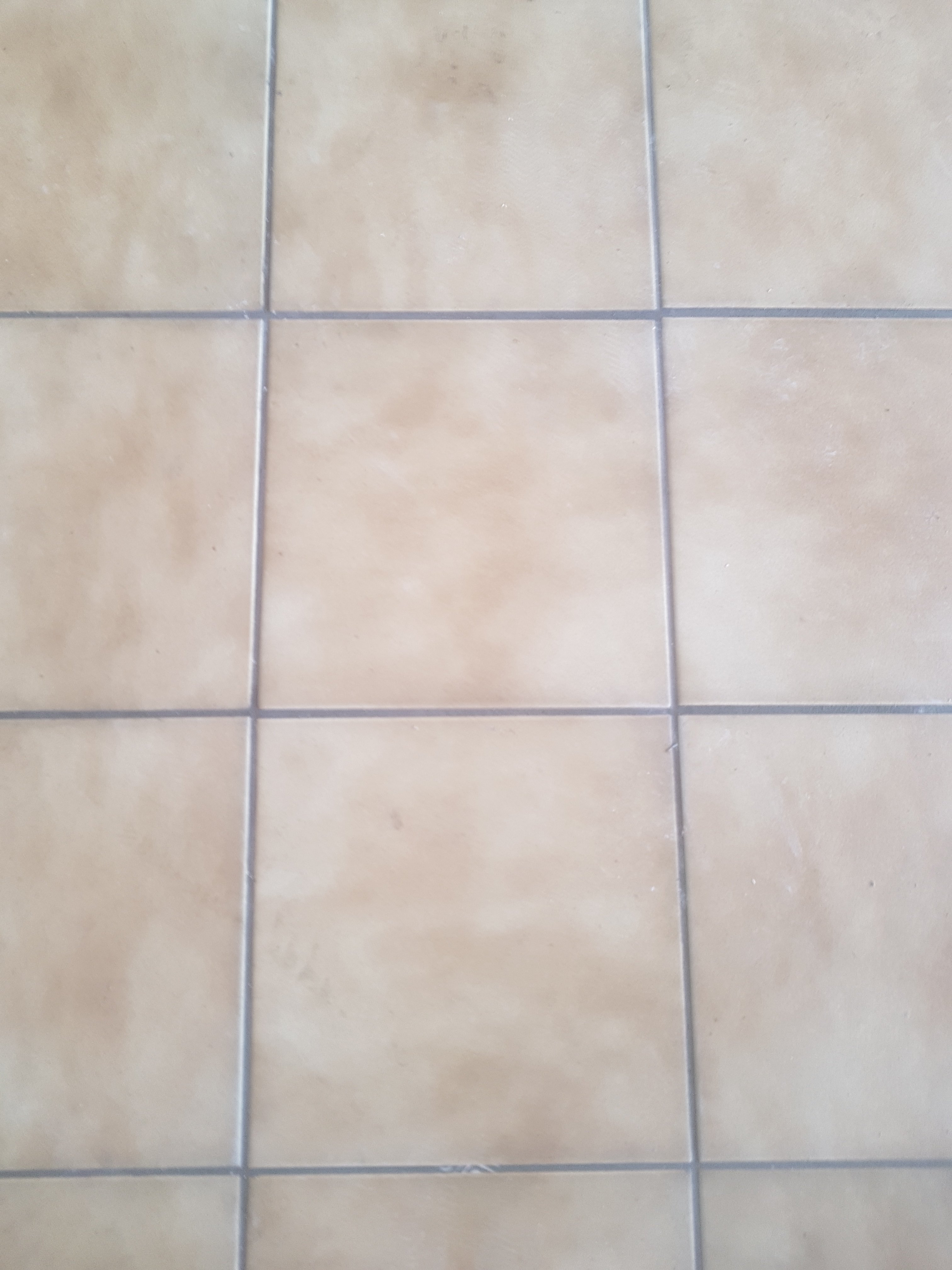

my original post i stated the tiles were old quarry i think i was wrong do you know what these are from this really bad photo?
that primer hes using looks the part many thanks

Wayne Brown
213
Cant really say bud I would say that as long as they are sound and well fixed the job is possible, I used to do alot of work in school kitchens they would have a specialist firm lay the epoxy resin floor often it was over tiled floors best of luck . Kop
